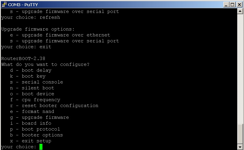

I am able to get into the routerboot through serial cable. It reads version 2.38.

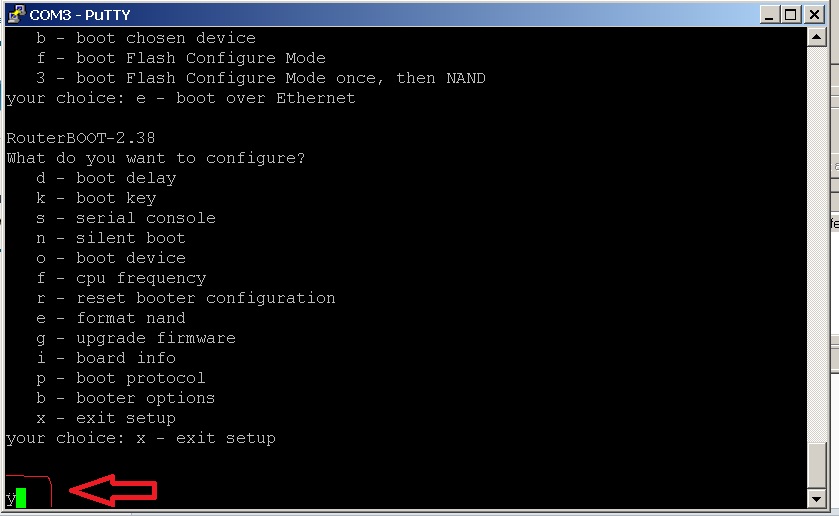

Then I hit o - boot device option in order to boot it through an ethernet port and then hit x in order to boot.
Then it just stays there and throws a character and never responds again
where could I get the firmware in order to upgrade via hyperterminal / serial port and see if this helps

http://routerboard.com/RB1200
You will see RouterBoot with link to download .fwf file, but I see it is same version as you have 2.38.
You can download it and try to reload it by selecting upgrade firmware in hyperterm.
