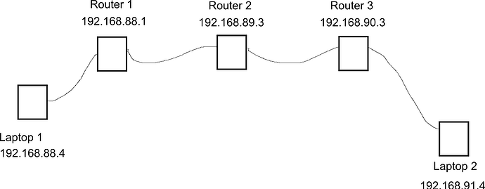

I recently purchased a few mikrotik routers and am trying to teach myself about static routing. Basically i have three routers, daisy chained IN SERIES (eth2 in, eth3 out) between two laptops. Im trying to figure out how to manually set the routing tables so i can have the laptops communicate across the routers. Please see the attached picture for a schematic of the layout.
I am not able to 'see out' past eth2 on router 1 (starting from laptop 1).
Here is an outline of the settings i have in place:

Mikrotik RB2011ViAS-2HnD-IN || "Router 1" - designated 192.168.88.1
add address 192.168.88.2/24 interface=ether2
on your laptop gateway 192.168.88.1 their default values
I think I should be 192.168.88.1
"/ ip address
add address 192.168.88.1/24 interface = ether2 "
Is there going to be an internet connection on this setup at some time? If so, which router will have the internet connection?
