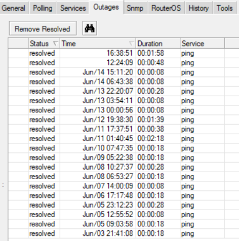

Dude outages:

Reinstalled the 3rd RB1100AHx4 tonight and did not have to wait longer than 2 hours for the first interruption. This time it lasted 2 minutes as reported by Dude.

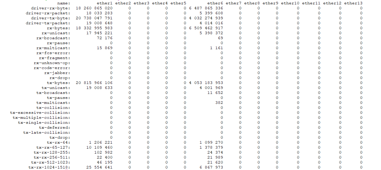

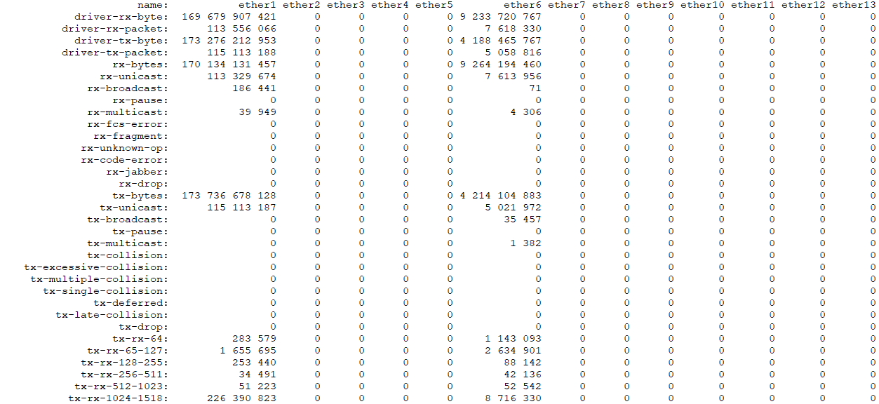

/interface ethernet print stats taken after the 1st incident shows:
Stats after 11 hours uptime:
It seems quite probable that your ISP is having problems.
But just as a try. Disable dude monitoring of your router.
I have had some troubles with a RB1100AHx4 that seemed to be caused by monitoring by Dude.
So actually no Rx errors at the 1100 side at all. Unfortunately (or fortunately?), this still does not mean that there is no L1 problem, so if you can put a dumb switch between the 1100 and the ISP’s port, do that. If it is still bad, keep the same dumb switch in place and connect, instead of the 1100, something that you have tested before to be working, to make sure that the dumb switch itself doesn’t have an issue with the ISP gear.

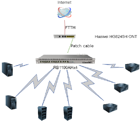

Is this run on your border gateway? The first hop printed by traceroute is already router beyond the device running traceroute. If it’s your border gateway running it, this means your link is failing. With that many different devices showing same symptoms it might actually be the line failing … or ISP’s gear. This is the reason I like to keep some ISP’s gear at my place … so that the line between ISP gear and my border gateway is well defined and easily replaceable (patch cord).
No BGP.
Just ISP > ONT > Mikrotik.
Direct connected IP on one ether and a subnet on another ether.
The netwatch and script is run on Mikrotik
Simple diagram
I mentioned border gateway (without P) … in complex setups there might be multiple routers, but usually only one is border gatewa / router whic is demarcation point between your LAN and the rest of internet.
Anyhow, I’d say the problem is ONT or fibre between ONT and ISP … specially so as you made a service break (by disconnecting optic connection) in controlled conditions and yet ISP claims everything was just fine …
The only argument against this assumption is that the test with nothing-to-do-with-RouterOS device as described in post #2 has shown no issues for two days, but I deem that adrgument quite strong.
