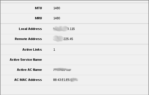

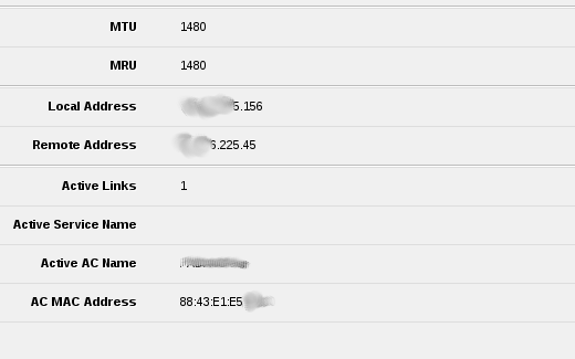

Whats obvious is, that I get different IP Adresses from ths ISPs PPPoE Server for my client
BUT all PPPoE Endpoint IPs are exactly the same…
I think that’s the main Problem…

(I smeared the identification parts out, but they are absolutely the same, the only difference is the local ppp Adress…
