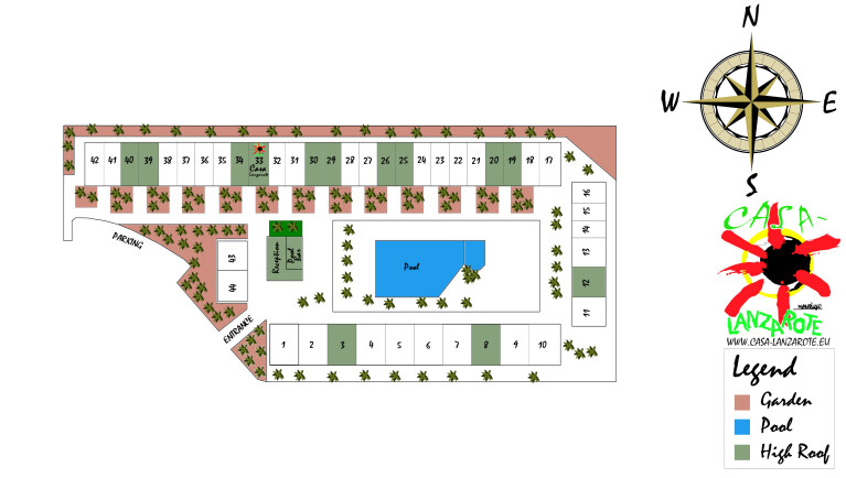

forgot to mention appartment complex is about 105x50meters main reception is in the middele of it all and used to have an telphone and internet so the unit is comming on the roof here to get a view see attachment.
and yes most of the time bigger = better, but the budget for this project is limited (altough I would love to have 4x90degree sectors on the roof here).
I tested it on july this year with a linksys w54g with 2 5dbi omni('s) and got a good quality signal in nearly all apartments.
(there is not a lot metal used in the buildings)
and a plus karma for youre thinking with me on this :slight_smile:
Greets Jasper
