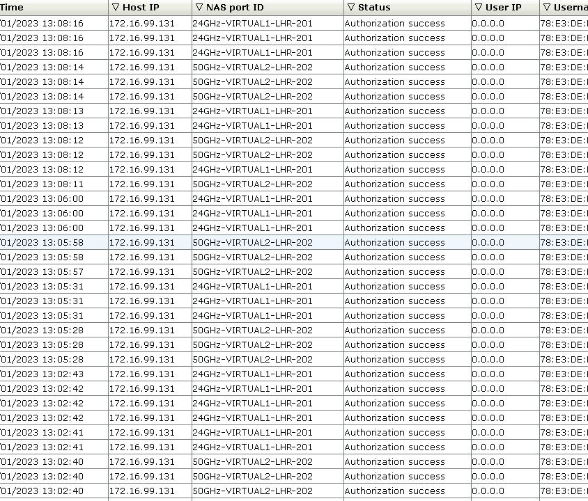

30 and more identical registrations with the same MAC address. Despite the userman setting: shared users=1
I use the WiFi Hotspot and Userman under RouterOS V6.45.9 plus DHCP-Server. All are in one device the RB1100AHx2. I created 4 SSID for our campsite. Guests use 2 and are unlocked via hotspots and password. This works without any problems.
The employees access the Internet via the 2 remaining SSIDs. Without the Hotspot - the Userman is used to unlock the MAC address.
Now the problem… In the LOG of the Userman, the same MAC addresses appear up to 30 times in a row and the note “Authorization success”. The “shared users = 1” (inside userman). Why?
The internet works without any problems.
In the access points, under Radius I marked only “wireless” and changed the timeout from 300ms to 1000ms. Without success… Please can you give me a tip.
Thanks and regards
Well I see no conflict with “shared users = 1”. It looks like the same one user (in this case MAC address) is used for one MAC address authorisation.
The frequent authorisation is something else. Need to find the root cause. At least every wifi disconnect/connect will normally send an authentication request to RADIUS (User Manager).
Client flapping between 2.4GHz and 5 GHz radio will send many requests. The authorization has no time-span for the authentication/authorisation part. It can happen 100’s of times in one second.
Only the RADIUS accounting part would keep track of the time the autorisation is in use, and could detect multiple uses of the same user.
The timeout is the allowed time for a RADIUS server to respond. The AP may retry if no timely response, but also the client may retry. The LOG says success, but the RADIUS answer may not have reached its destination. If no success in Internet access the client will move to another SSID/AP/channel. There are some double requests/answers here (300ms = 3 in one second), but 5 seconds is very long for a wifi connection, that’s probably another association attempt.

That rapid succession in the log? Don’t know for sure, but I can imagine if the response is not reaching the AP or client (path, encryption, certificate, not-acknowledged accounting … whatever reason) the request would be repeated 3 times (every 300ms) before the client migrates to the other radio or AP, and restarts the 3 times repeated request.
