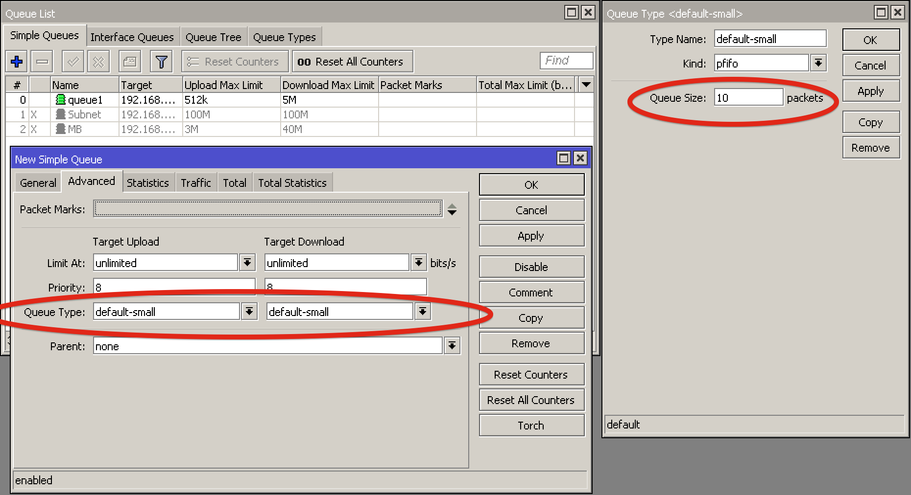

Your problem is probably the same problem I experienced recently. Change your Default-Small Queue Size to 75-150 packets or create a new Queue-Type for your larger throughput queues.

I played with the packet size and got up to 40 meg throughput. Better, but not what I was looking for. I did the pcq type queue and I saw full throughput. My question, Can I create separate pcq queues per ip address similar to what I was doing with simple queues? I read up on the pcq queues and it seems as it is more of a global speed limiting type function.

What was your queue size set to initially? Was it PFIFO default-small or default? Default-Small is set to 10packets and I get much better results when changing this value on every range of routerboard (CCR to RB951-2n)…
