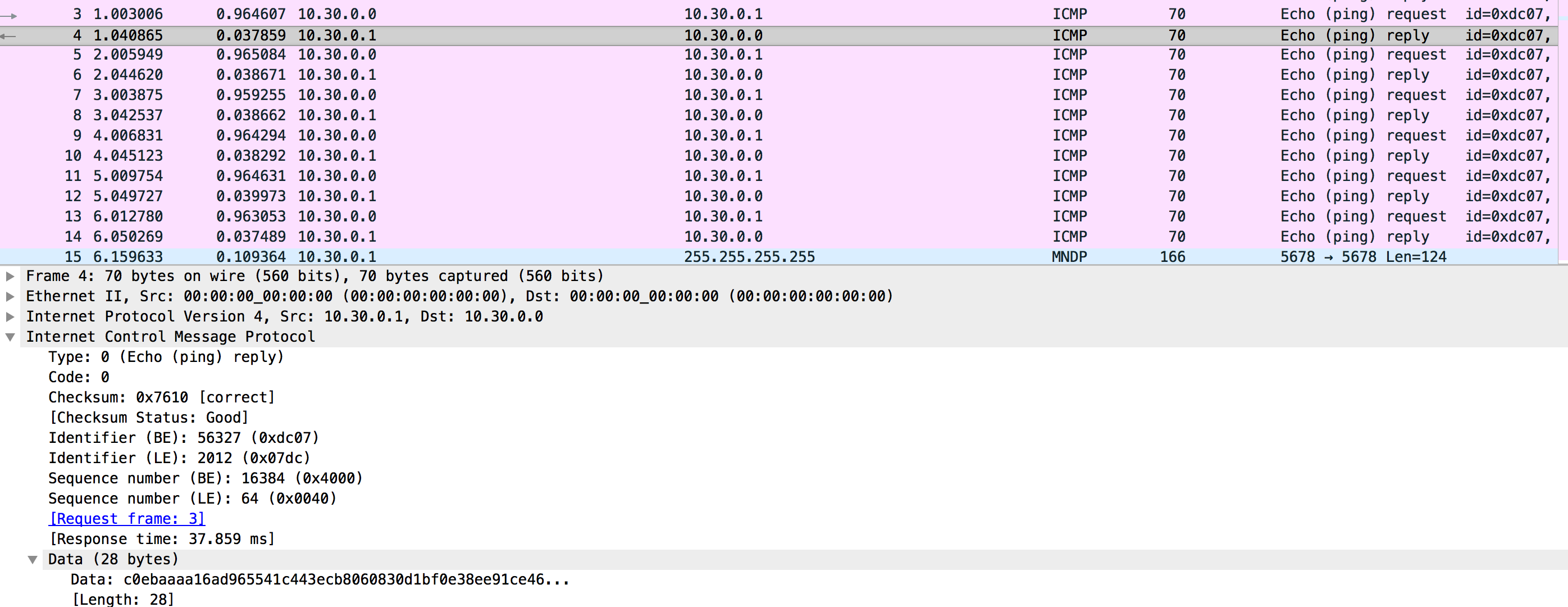

However, if I change the GRE tunnel addresses from 30 bit masks to 31 bit, 10.30.0.0 and 10.30.0.1 to be precise, pings don’t work. I get a timeout on each end when I ping the other end.
But if I do a packet sniffer on the GRE interface, I can see the ping replies! What is wrong then? Seems like I shouldn’t get a timeout on the ping if I can see the reply in the traffic right?
