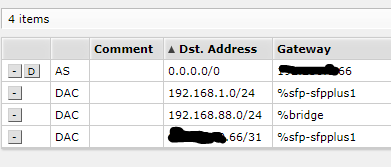

This Is what should look like.
Ignore the 192.168.1.0 entry. (I have a GPON stick and that is the address to control it)
My static public address is: x.x.x.67
