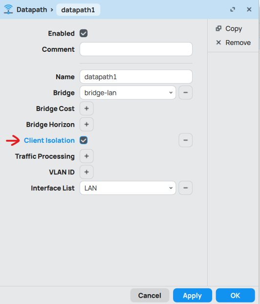

You can use …/datapath/client-isolation=yes
Ah, I see. So it is located as a tab under WiFi (I don’t have anything there yet). Am I correct in thinking this would isolate all devices connected to the interfaces in the Interface List (in your screen clip, LAN)? I would want to be able to only enable it for unrecognized devices.
Set a separate SSID for untrusted devices and a datapath for them where you set client isolation.
Gotcha. Thanks for the tip!
