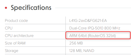

Please apologize for maybe a dumb question - but why are there certain MikroTik products with 32bit OS on a 64bit CPU architecture available?
Why don’t these devices also obtain a 64bis OS?
Just out of interest…

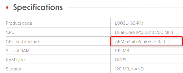

This model runs 32bit OS because it does not have enough resources to run 64 bit OS. Since it’s a lightweight home device, there is practically no benefit anyway. It is the cheapest device after all.
Can you elaborate about which resources on L009 are scarce?
+1
Would be interested in this as well.
More specifically, there is no performance difference or any other gain to add 64bit support if you only have 128MB of RAM, the differences begin with bigger RAM.
Hence the question why an L009 with 512MB memory is not getting enough love to give it a 64bit OS?
Like I said, the lack of RAM is not a problem.
There is no benefit for device with only 512MB RAM. You need 2GB to feel any difference.
64Bit OS takes up more space and can be even slower if you only have 512MB
