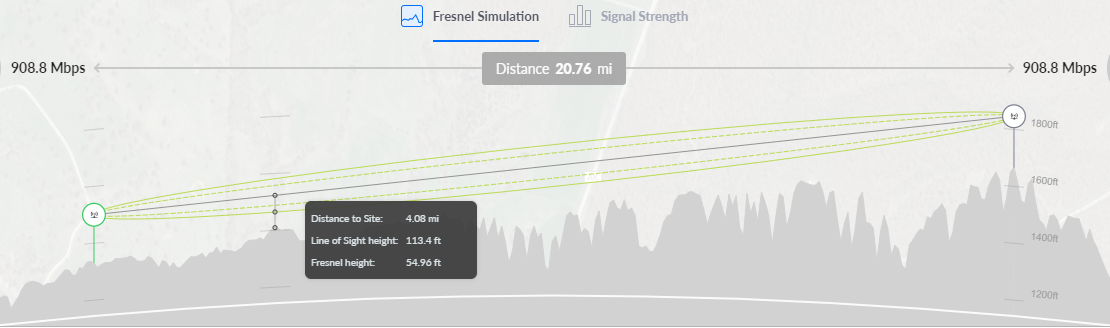

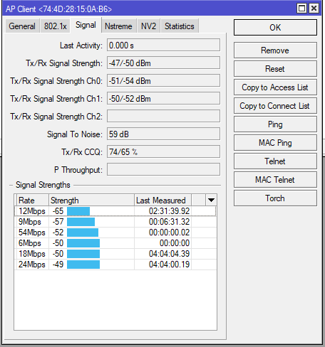

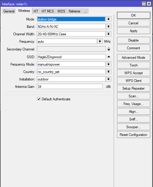

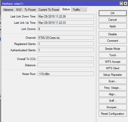

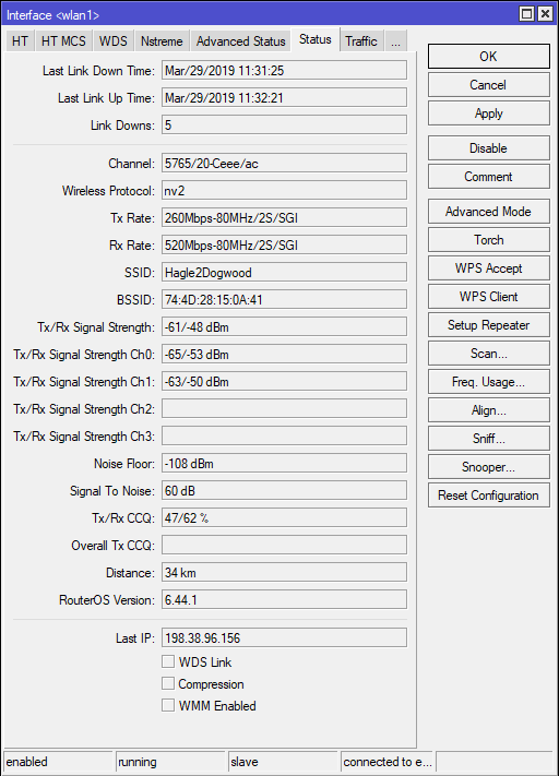

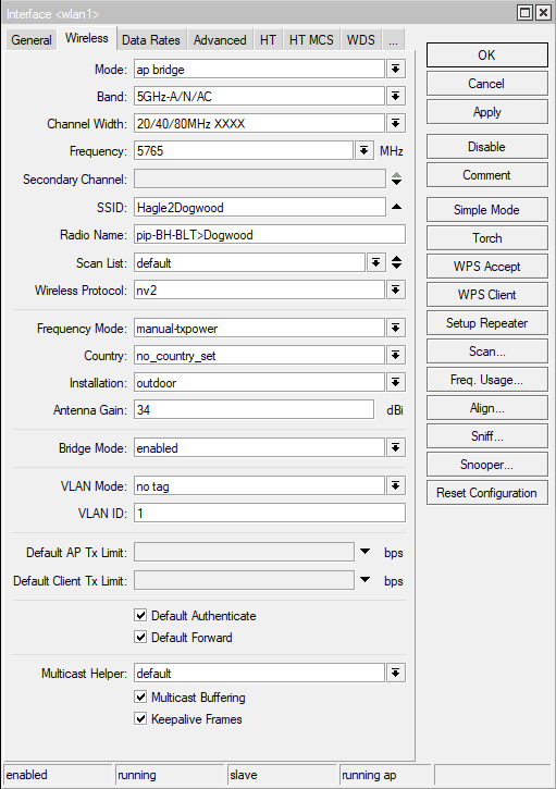

We have setup a 34km link, signals are bouncing around between -65 and -48dBm. CCQ is running between 40 and 64%. We dont see much in the way of interference. Anyone have any ideas on how to tune this link? We spent around a couple of hours finely tuning the alignment.
Both radios are a NetMetal 5SHP.
Hooked to RocketDish 34DB Dishes.
One side is mounted roughly 6ft from the top of a large water tower. Around 160ft in the air. Lots of competitors are on the tower with us.
Other side is mounted 185ft on side of a tower. We are the only ones on the tower, we kept our other radio frequencies far away from this one. around 15ft separation.
Complete line of site for the link and roughly 20ft from the estimated fernel zone.
This is our first Mikrotik Link, we have used Ubiquiti before.

Is this a shot over Water?
Nope, all over land. Running the link calculator, looks like the closest object to the Fresnel zone is 54ft away.

Have you also tried seeing it up as Greenfield, not a/n/AC?

Did not see much channel usage for this frequency in the snooper, freq usage or scan. What option is Greenfield. I am currently researching it.

It’s an expression meaning that you don’t mix modes (a/n/ac) but rather stick with just one (ac).

Ok thanks, we was already thinking about changing that. We will test Sunday.
Use that mikrotik protocol thing
NV2 :wink:

Have you tried reducing channel width? Try it at 20Mhz and see if the CCQ improves. If it is fine, bump it up to 40Mhz and retry until you find where it is bad.
We tried that and no change in ccq. We changed from nv2 to nstream and we are currently running at 99% ccq. Signal level dropped to around 57. This link is rocking now. Currently ordering more netmetals to replace more links.
