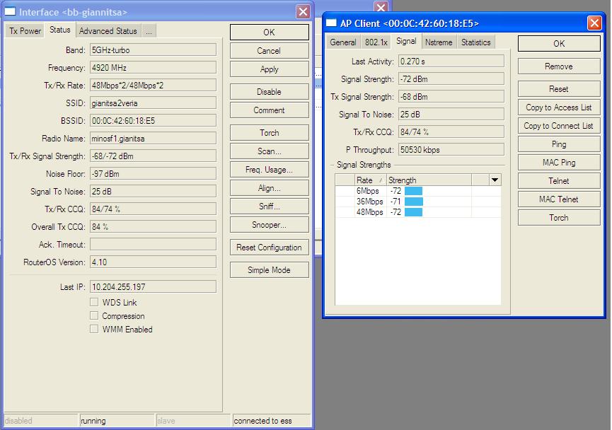

I will post some photos and screenshots so that you guys can help me because i see there is a lot of knowledge here! Thanks again
These are the details of the link.
