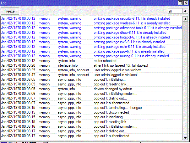

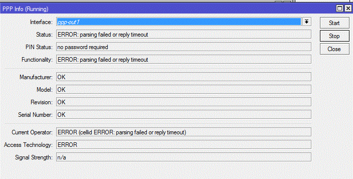

I’ve tried few Sierra Wireless modems (MC8780, MC8775) - but no internet connection, both modems are supported by mikrotik according to: http://wiki.mikrotik.com/wiki/Supported_Hardware
I’m using ROS v.6.11 and routerboard firmware : 3.13.2 - default configuration.
I have attached some prtscreens in case that somebody encountered the same isusse.

Disable PPP-Client interface made by MC8775 Module and then get INFO. you will be see more info like:
[admin@MikroTik] /interface ppp-client> info
number: 0
modem-status: ready
pin-status: no password required
functionality: full
manufacturer: Sierra Wireless, Inc.
model: MC8775
revision: H1_0_0_7MCAP G:/WS/FW/H1_0_0_7MCAP/MSM6280/SRC
2006/10/26 17:31:03
serial-number: 352905010206401
current-operator: Limited Service (cellid unknown)
access-technology: 3G
signal-strengh: -87 dBm
frame-error-rate: n/a
