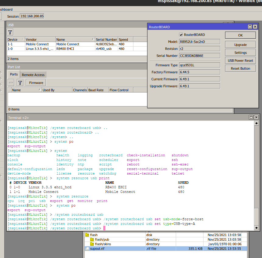

Good day. I have a LTE USB D-link modem that appears in usb resources but not in LTE interfaces or Ports.

D-Link DWM-222 4G LTE USB Adapter (4G modem), Cat.4, PN : DWM-222

These USB modems often used to show up as “mass storage” (disk) containing the driver for Windows and required a mode switch command to start identifying themselves as modems. I’m not sure whether RouterOS handles this at all, and if it does, whether it has the mode switch commands for all the USB devices found in the wild. So if you can, use a linux PC to find out how the D-link thing behaves, and eventually find out how to switch to “modem only” mode permanently (as in “will show up as a modem straight away at next plug in”).
Thanks. Yes, the microtik identified the modem as a disk drive. How can this parameter be changed to identify it as a usb LTE modem.
Marcel
It depends on the type of the modem. Here’s the home page of the usb_modeswitch project, the particular commands to be sent are model specific. But you really need a Linux machine for that, no way to change that from RouterOS. And the second issue is that not every USB modem can be set to remember the change if you disconnect it. I did that back in my OpenWRT days, years ago.
Yes, that tool is part of my Ubuntu OS, but it only switches the mode on my PC, not permanently to microtik :frowning:.
Thanks, Marcel
You have to google for detailed information for that particular modem type. I was able to switch several Huawei 3G modems permanently, but never had a D-link one. Another possibility is that the usb_modeswitch actually is part of RouterOS but the parameters for this D-link have not been added yet, so opening a ticket at Mikrotik support may be the right thing to do.
Viem písať aj po slovensky, len toto fórum funguje ako knowledge base aj pre ľudí, ktorí o stredoeurópskych jazykoch ani nepočuli :slight_smile:
Maybe try v7rc7? It has a newer linux kernel that may know the right thing to do, which be the ROS version of usb_modeswitch. But not sure v7 help much with the D-Link DWM-222 since I think it only does QMI, not the MBIM or ECM supported for “LTE” on a Mikrotik. So it be a PPP Client device using data-channel etc.
You may be best to see what happens under Windows, if looks like a disk, install their drivers. It should be in modem mode, then be more likely to at show up as a port on a Mikrotik. There may be firmware update that be good to do as well – maybe a newer version can “remember” it’s USB-ness and/or support ECM/MBIM for v7.
Quick google, suggest the D-Link DWM-222 modem mode should report USB device ID of “2001:7e35”, and NOT “2001:ab00” which is a disk type.
Otherwise, you’d want to make sure you open a case with Mikrotik including a supout with the modem connected, perhaps rebooting before collecting the supout so the logs are cleaner.
I’m trying to install on Windows. I’ll see if it switches to 7e35. Today, it is difficult to buy a suitable certified USB LTE modem that will only work as a modem. I wrote in support.
