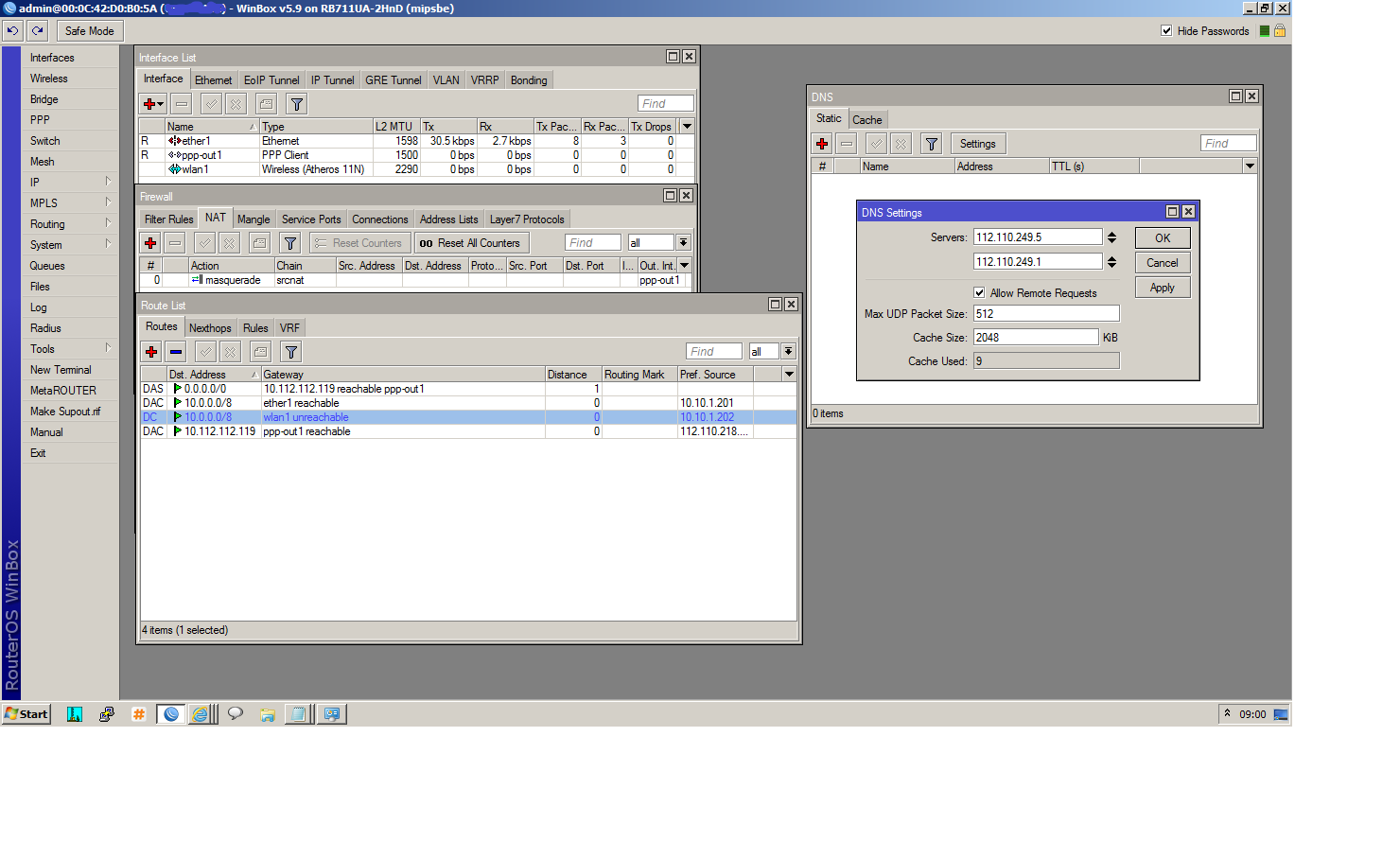

following are my settings…
normis… yelp!!!
these are my settings below…

0 chain=srcnat action=masquerade out-interface=ppp-out1
still not working :frowning:
although i can ping any website from the Winbox Terminal window… i cannot browse or ping from the laptop connected to this Routerboard on Ether1.
