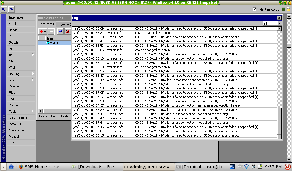

3KM Link Disconecting intermitently
I have deployed several mikrotik point to point link ranging from 1km to 28km and are all working fine, some have been working for over 4years but just deployed a 3km link recently and have been battling to get it to carry 1meg of data all to no avail.
The Details:
RB433AH at both end,
R53Hn wireless card at both side
27dbi grid antenna in use at both end
1m Low Loss Jumper cable between radio and antenna
Installation carried out at 100ft above water level at both side,
Signal Strength is -56/-58,
Configuration:
Just a simple bridge of all the interfaces,
The link is working but disconnect with the following error messages at will (see Attachment).
The problem is the link will work well for like 30min or less and disconnection and reconnection process will start during which users connection will be timing out.
I have tried the following:
I have changed the board to RB411, Cards to R52, no solution.
Have tried all frequency starting from 5180 - 5805 all the same. the above is the snap short taken yesterday.
help is needed urgently please.
There seems to be several users experiencing this problem. Some users get
lost connection: no beacons received
or
lost connection: not polled for too long
or
lost connection: medium access timeout
These errors appear to be associated with the beacon packets (or lack of beacon packets), not with a loss of signal or noise. I am working with Mikrotik support to correct the beacon packet problem now.
You might want to generate a supout.rif and email it to support(at)mikrotik.com with an explanation of the problem. So far, they are having a bit of a challenge believing me. :confused:

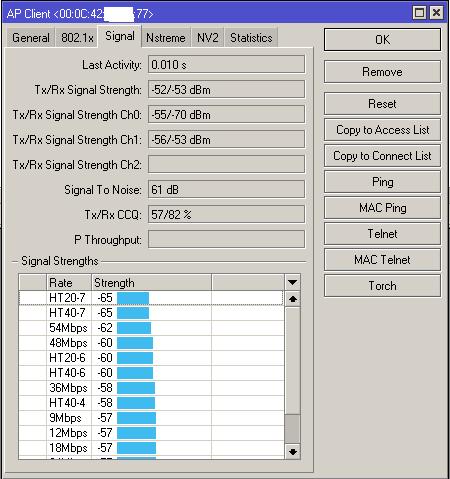

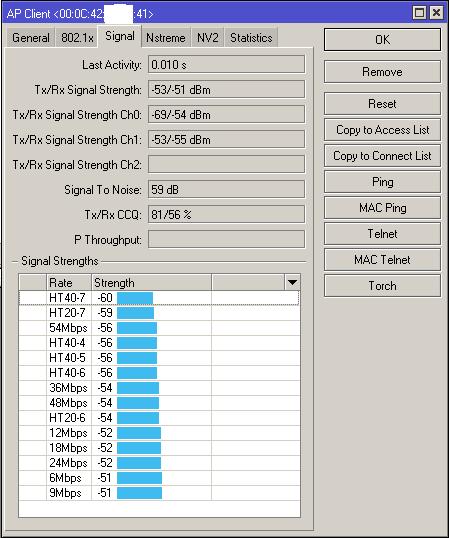

What I noticed, what will I do:
  • install NTP :slight_smile:
    firmware on cli is strange (current-firmware: “”), will try to upgrade
    signal on Ch0 is asymmetric, crew have to climb and check cables and alignment
    WDS is a result of the standard 802.11n setup and is unnecessary, have to try with station
Will post progress report.
