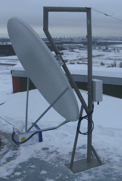

Now I have is offset antenna with bipolar radiator. That is, mimo2x2. Radio link throughput ~ 200 Mbps half-duplex.
I want to replace the wireless card on mimo3x3 and make another radiolink mimo1x1 and connected to the chain 3 in wireless card.
What do you think?

from USA Las Vegas. PDF
Wow! What are the antenna and the wireless card did you use? What is the distance between mikrotik?
etc
