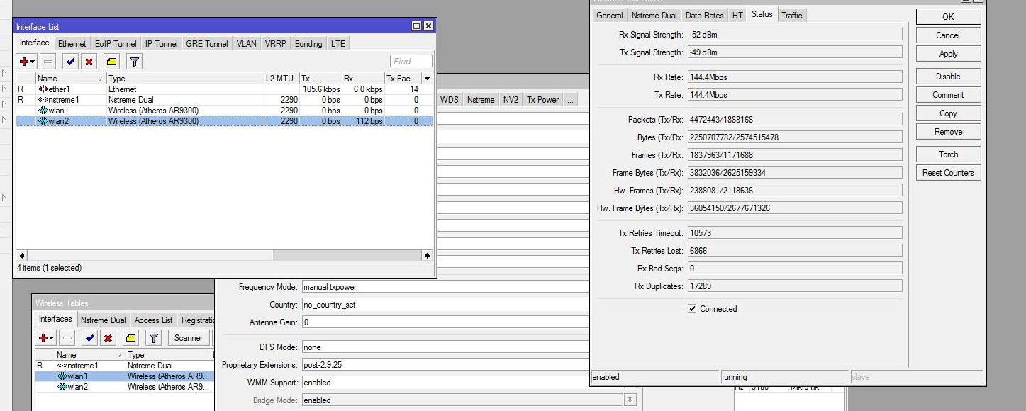

Now i’m testing three cards of this type in one motherboard.
More info in polish with some screens are here:
https://isp4isp.pl/forum/topic_show/7798/
I have tried to setup NS-Dual link. And i stuck with proper configuration.
Link works only with 2 chains, 20Mhz channel (MCS15 with 400ns GI). It’s possible to transfer 120Mb TCP fdx (tested with BT). How can I enable three chains and 40Mhz channel? In HT configuration (with NS-Dusal window) I can set only single or both channels, so maybe it’s bug in software?
Little sample from working link is below. Max connection speed is 144Mb :frowning:
