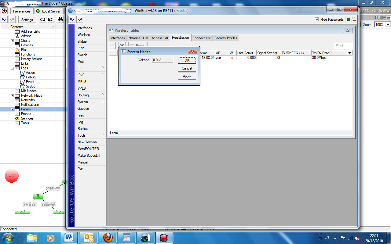

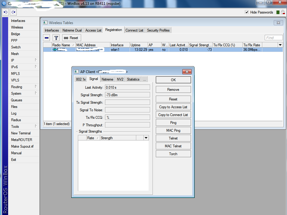

Since i installed 4.13 i gained Nv2 great but have lost,
in wireless status tab - CCQ, in wireless registration signal tab - Tx signal, signal to noise, CCQ
system health - incorrect voltage
Can i ask when will these be back in winbox.

please upgrade to RouterOS v4.16 and check again.
Upgraded to 4.16
This version has solved under wireless status & registration CCQ and signal to noise, thank you,
But in system health voltage is still incorrect at 0.0v?
To measure the voltage is needed RouterBOARD with 633Mhz Processing (433AH, 493AH, 450G).

I have a 493AH and get this:
[@RamTrail493] /system health> print
fan-mode: auto
use-fan: main
active-fan: none
Winbox shows 0.0V (v4.16)

I also miss voltage correct values on RB493AH, I’ve mailed support, but answer was for me
useless. Does anybody know on which version of ROS / RB493AH volt reading works correctly?\
Voltage reading is working OK for me using 4.16 on the RB493AH and UAH with dude v4.0 beta2
unfortunately my rb493ah still
shows 0.0V in winbox and via snmp/oid too.
i’ve upgraded to 4.16 and no luck.
me too. did they forget the sensor chip on the newer 493ah boards?
Sorry typo error should have been RB433AH is OK but not as posted RB493AH which still has voltage at 0.0v?
Did anybody managed rb493ah to show voltage readings??
please HELP!
