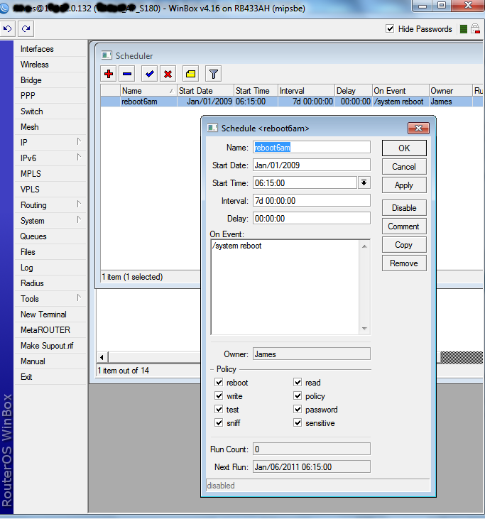

I have scheduled a weekly AP’s reboot and had upgraded to 4.16 about 2 weeks ago, so a reboot had been done last week?
There is a 5min interval between each of the AP’s : 06:00, 06:05, 06:10, 06:15, (screenshot below)
Should i increase this interval.

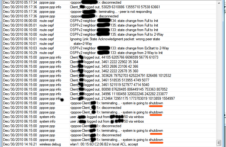

This morning the weekly 06:15 scheduled reboot of this AP caused a “shutdown” while the others rebooted OK? :confused: (screenshot below)
