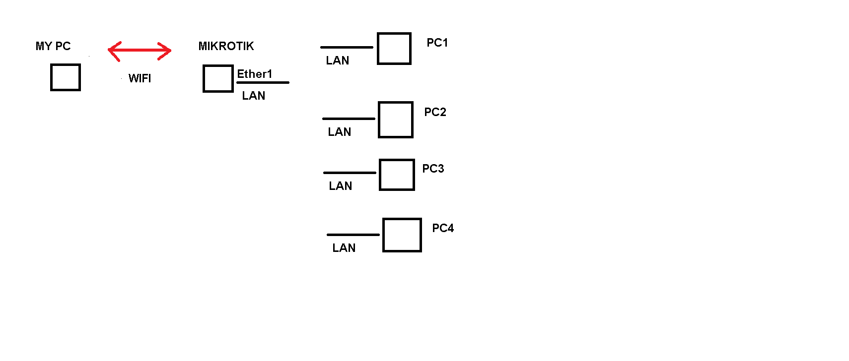

SO I described it wrong. Here is a picture.
So how to describe the name? I know that it can be set in the network card settings, but I need to connect using WIFI, since I am connecting to a device where there is no access (elevator CPU).
I often connect to other devices, but always with the same IPs, I actually use 4 IP ranges. Is this possible to set? To have DHCP on my PC and depending on which of the 4 devices I connect to, it would take settings accordingly. That should be set, the gate would always have to be set, right?
Multihoming in general, IP aliasing when the multiple networks are on a single L2 interface, without something like VLANs or VPNs to split them up at L2.
That has no relevance as long as the WiFi interfaces are on the same bridge as ether1. The technique I referenced above works under that condition, too. The only wildcard you’ve added to the game is…
That complicates things due to weaknesses in the Windows network stack, but as long as you’re using a relatively recent version, there is now a workaround.
I don’t need to have DHCP set up on my PC. So the best option is to always change ranges, or have 4x mikrotik for each PC.
I am using Windows 10. The problem is that I have a company PC and I have to enter passwords every time. It really bothers me and keeps me away from work.
so I’m looking for a solution to have my computer set up so I don’t have to enter passwords all the time when changing IPs.
Then why did you bring it up above?
No, the best option is to multi-home your PC. Put one IP for each subnet into the computer, on the same interface. If you give it 10.10.10.2, 192.168.66.2, 192.168.64.2, and 10.0.0.2, then when you connect to the elevator control PC at 10.0.0.3, the source IP will be 10.0.0.2. If you connect to 192.168.66.3, the source IP will be 192.168.66.2 instead, even though it is coming from the same computer, via the same WiFI network interface.
You can continue spending time arguing about it, or you can try it and find out that I am correct.
