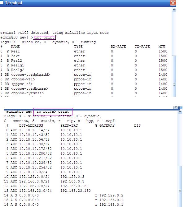

post results of ‘/ip route print’
hiiiii
that’s not the result of ‘ip route print’ - it’s a snapshot of the winbox routing table. it doesn’t show all the info.
anyway…
please /also/ show us the result of ‘int print’ as well as ‘ip route print’
cheers.
hiiiiiiiiiiiiiiiiiiiiiiii
OK, thanks.
Just one more: ‘ip address print’
it would help a lot if you just highlight the text in the terminal window and right-click-copy then paste into the forum text editor.
Cheers.
I would just like to quickly point out that using MLPPP and combining all four circuits into one - as you are asking in your other thread - is the opposite of what you’re asking in here, and you cannot do both at the same time.

OK, have you got NAT rules set up for each outbound interface? Each one probably need a src-nat or masquerade to make sure that the source address of outbound packets matches the interface that it is transmitted on.
It may also be easier if you can just attach your supout.rif
Cheers,

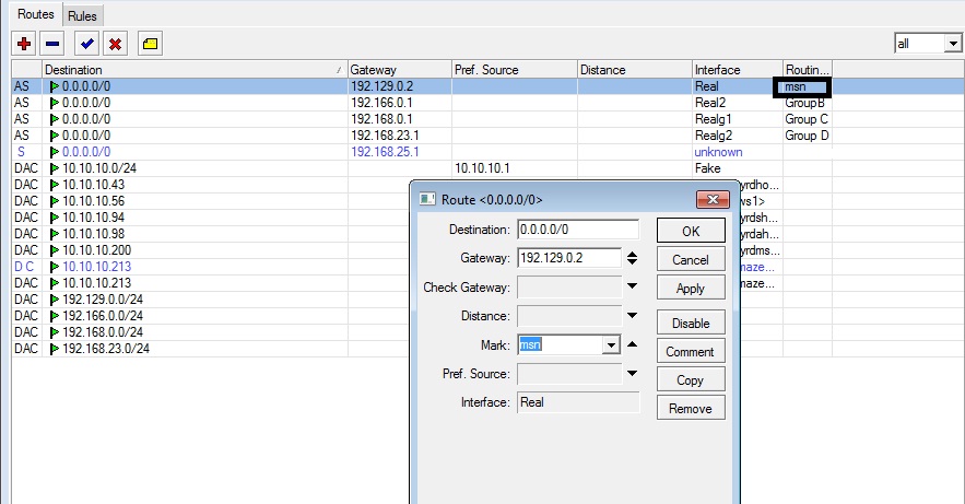

so lets get this straight: if you disable the mangle rule you show above, then msn works. when you enable it, doesn’t work.
is that essentially right?
  • this mangle work for browsing ,all port
    chain=prerouting src-address=10.10.10.0/26 action=mark-routing
    new-routing-mark=GroupA passthrough=no
  • this mangle for msn not work
    chain=prerouting src-address=10.10.10.0/26 protocol=tcp dst-port=1863
    action=mark-routing new-routing-mark=msn passthrough=no
What about of you change the first rule like this:
chain=prerouting src-address=10.10.10.0/26 action=mark-routing new-routing-mark=msn passthrough=no
Cheers.
  • i change new-routing-mark to msn also i change route..Mark= msn
    yes there is internet..
0 ;;; GroupA
what version of ROS are you using ??
v:3.20
I think that you have identified a problem with your nexthop path via 192.129.0.2 - what /is/ that address anyway? can you ping it? if you connect just a PC to that gateway, can you get internet access that way?
Cheers.
i changed to next route it is work thxxx
