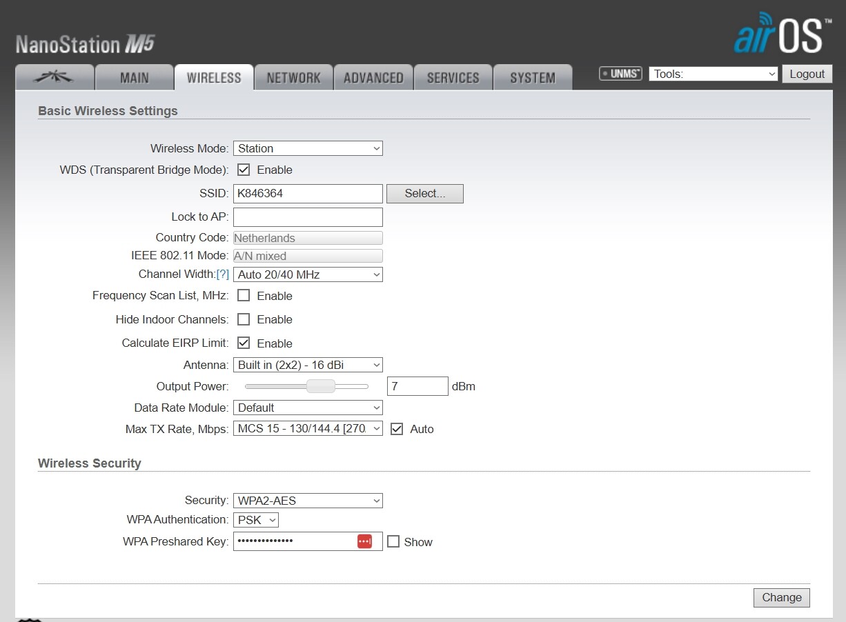

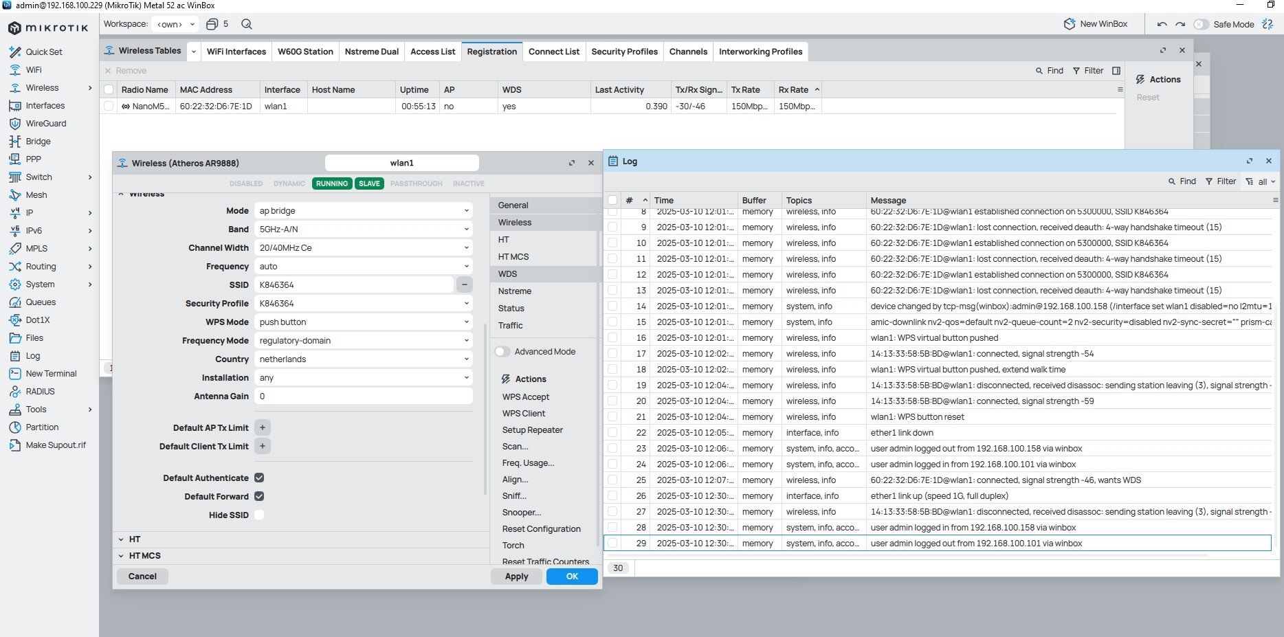

I have an issue if I try to connect the MikroTik Metal 52AC to a Ubiquiti NanostationM5 access point. When the NanoM5 is running as a access point with WDS bridging capabilities and the MikroTik Metal 52AC is setup as a Station-wds it always fails with the 4-way handshake failure if WPA2-AES PSK is set. If I remove the WPA2 on both devices the two devices work as expected (working WDS).
I have also tried running the MikroTIk metal in standard Station mode with the WPA2 enabled and it will connect to the NanoM5 Without any issues using WPA2-AES PSK (Only that of no layer 2 transparency).
I have also tried running the Metal52AC as a accesspoint bridge and the NanostationM5 as a station-wds using WPA2-AES PSK and this worked. The issue is that in our application the NanoM5 cannot be used as a station-wds.
Is there a solution such that i could run the Ubiquiti Nanostation M5 as an accesspoint while the MikroTik metal 52AC is running as a Station-WDS both using the WPA2-AES PSK encryption?

This setup doesnt work but it is the wanted setup (Ubiquiti AP+WDS and MikroTik station-WDS)
![ThisSetupDoesntWorkButIsWantedNanoM5_AP4}.jpg|1226x899
This setup does work but the implementation is flipped: (Ubiquiti station WDS and MikroTik AP+WDS)
![ThisSetupDoesntWorkButIsWantedMetal52AC}.jpg|1728x856
