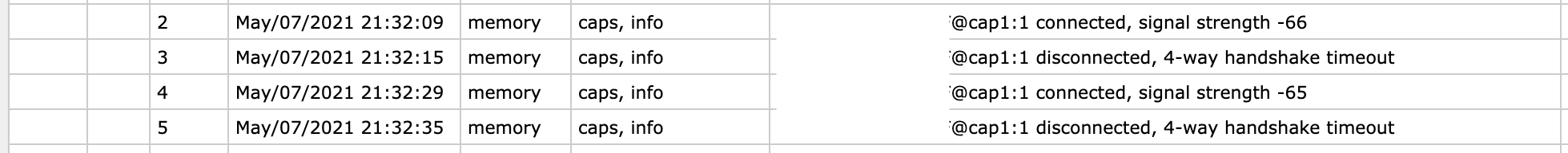

  • On the Routerboard with enabled debug logging, I am getting only these two messages with nothing in between:
	00:00:00:00:00:00@cap1:1 connected, signal strength -66
	00:00:00:00:00:00@cap1:1 disconnected, 4-way handshake timeout
  • After providing the password again, the device connects successfully, and it can last for another few hours.

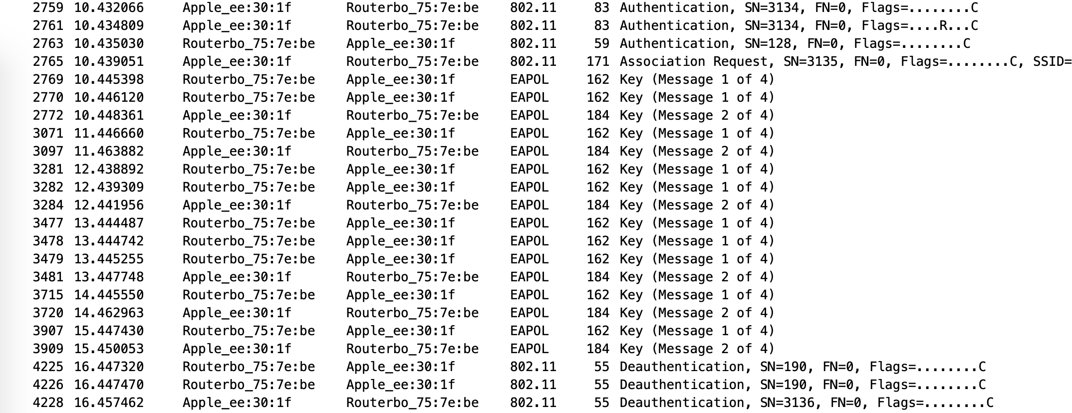

  • In Wireshark, I see that the handshake stops at the second message. The iOS device sends Nonce to the Routerboard but never receives the third message of the handshake containing GTK from the Routerboard
Here are the screenshots showing that:
