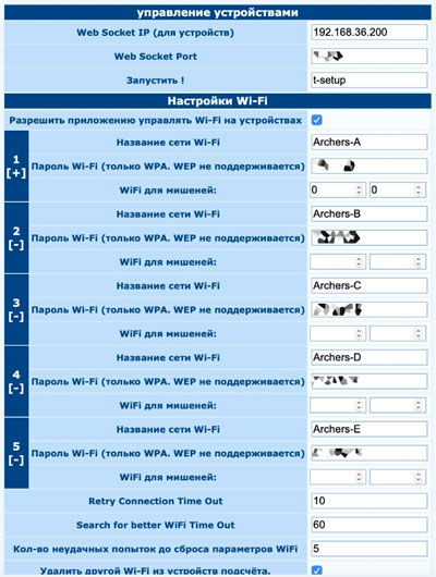

A currently used is “separate” system (different channels and different SSID for all АР) But the system works differently in different locations (relatively stable or very bad). Settings (in Mikrotik devices) not changed, “client`s” devices the same all the time.

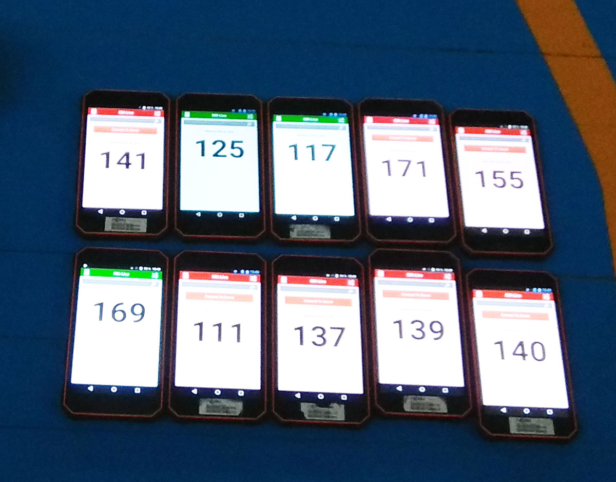

All client devices begin to transmit data at the same time (approximately every 5 minutes) - the rest of the time they are in “ready” mode.
ADD/UPD
Distance from AP place and Android device max 25 meters (but usually 2-5)
In post attachment device with Red “border” = not connected, Green = connected to any access point, (priority over the nearest)

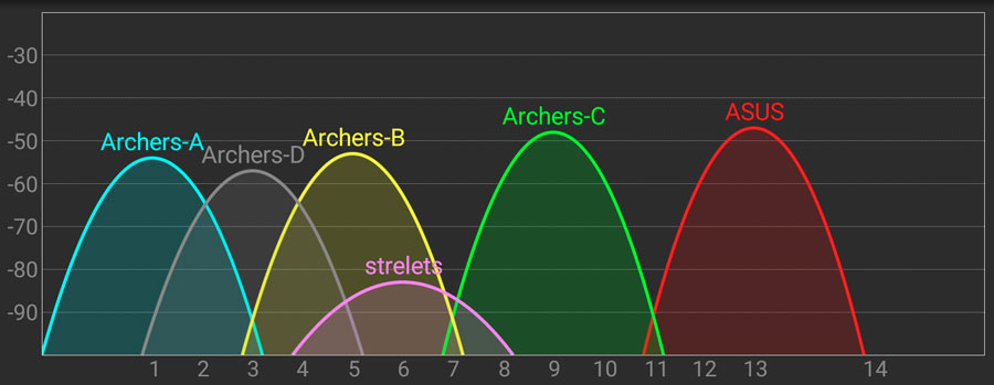

  • Different channels is a must, be aware that:
  • the 2G band is completely (over)saturated
    • you can only choose 1, 6 and 11 as non-overlapping channels
To have a proper functioning WiFi network you have to do a site survey. This is the only way to be able to set best channels.

    Some functionality of the judging program (it is possible to bind MAC address groups to specific access points) + channel adjustment (search for free channels and frequency shift)

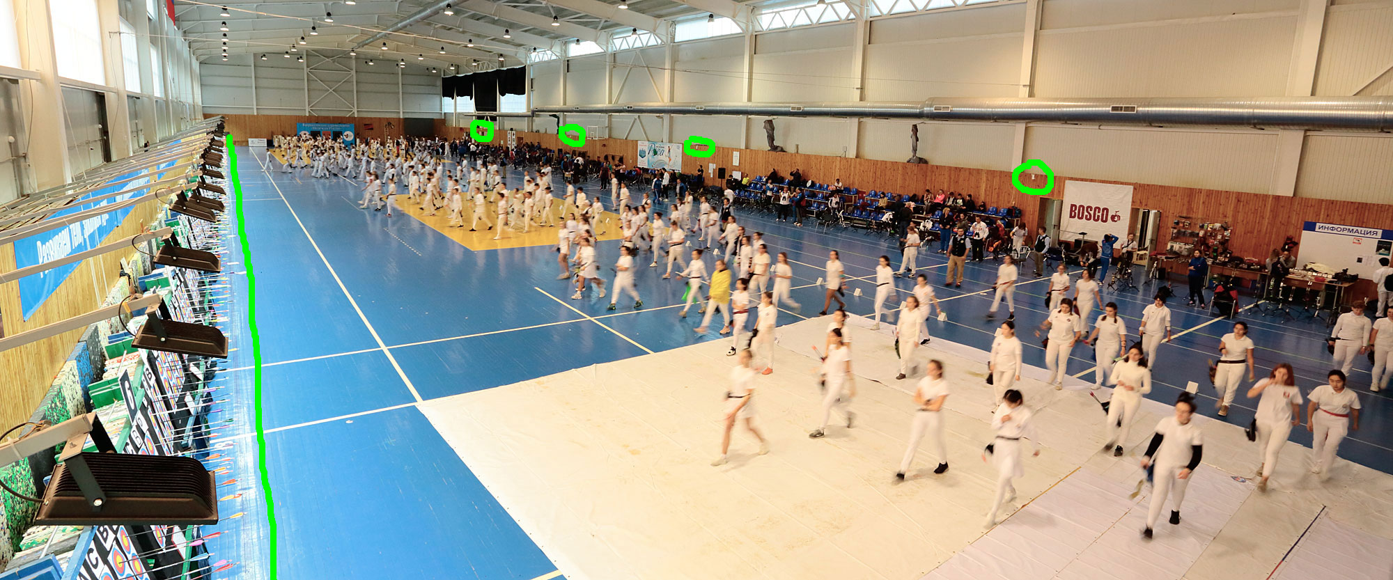

we used this system on the outdoor competition`s (4 access points worked in one area) - the circuit worked well.
Used this system in the hall (more precisely two - 2 access points on one floor, 2 more on the next, all points were visible on the devices (but the difference in signal strength was more noticeable).
The system worked just as confidently.
It may well be that these were “extreme regimes.” I do not know.
May I make a suggestion? From the RF engineering perspective, you can clear up the acjacent channel interference (remember the carriers have RF skirts and RF reflections off non-conductors and conductors in an enclosed space) greatly by not using the default antennas used in the wireless access points. I do have some very good experience in antenna design for 2.4GHz 30-50 km line of sight (you call this 2G, I think) and also 6/4 GHz, so the same basic principles would apply - with Mikrotik devices. Can you inspect your hardware/change the hardware type to use external antennas - to reduce the radiation pattern and side-lobes in vertical and horizontal directions. Explore the concepts of zones by adjusting the radiation pattern of the antennas by RF absorption (signal loss) or reflection (signal gain). I would absolutely in this open environment (thanks to the picture) use the lowest minimum power, and the tightest beam confinement antenna I can find, or construct, and I would expect to receive signals from APs all over the floor, depending upon the RF propogation/reflection. Only thing is that the RF noise floor would be better as the RF being transmitted in the area of interest would be more or less confined to that.

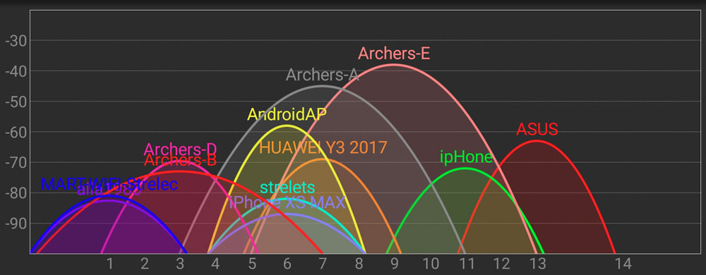

When checking the radio (using the WI-FI analyzer application), a situation was encountered with a very dense network of devices in broadcasting.
But even after the end of the day, when the participants dispersed and the air became “clean”, our equipment did not start to work efficiently.
In the day time (the wi-fi analyzer application) it sometimes showed strange situations, part of the AP (Archers-X) worked at the same level, and part could “fall” to the zero level, and rise again after 5-10-15 seconds. Perhaps this is the features of the application.

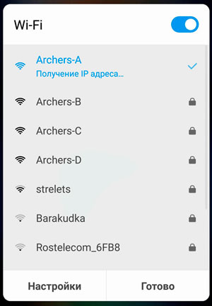

Plus, I experimented with connecting my smartphone (xiaomi) to any access points, my smartphone made the connection / authorization much faster and more stable.
