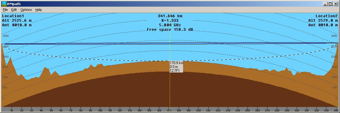

What are the GPS locations and the antenna heights?
Just a quick look at the elevation data, it looks like there is a possibility of a 341km link (if those places are accessible).
Otherwise I don’t see that there are any possible locations.
At a distance of 367 km, earth curvature is 2000m in the middle.
In short, you can’t even get close to 400 km.
