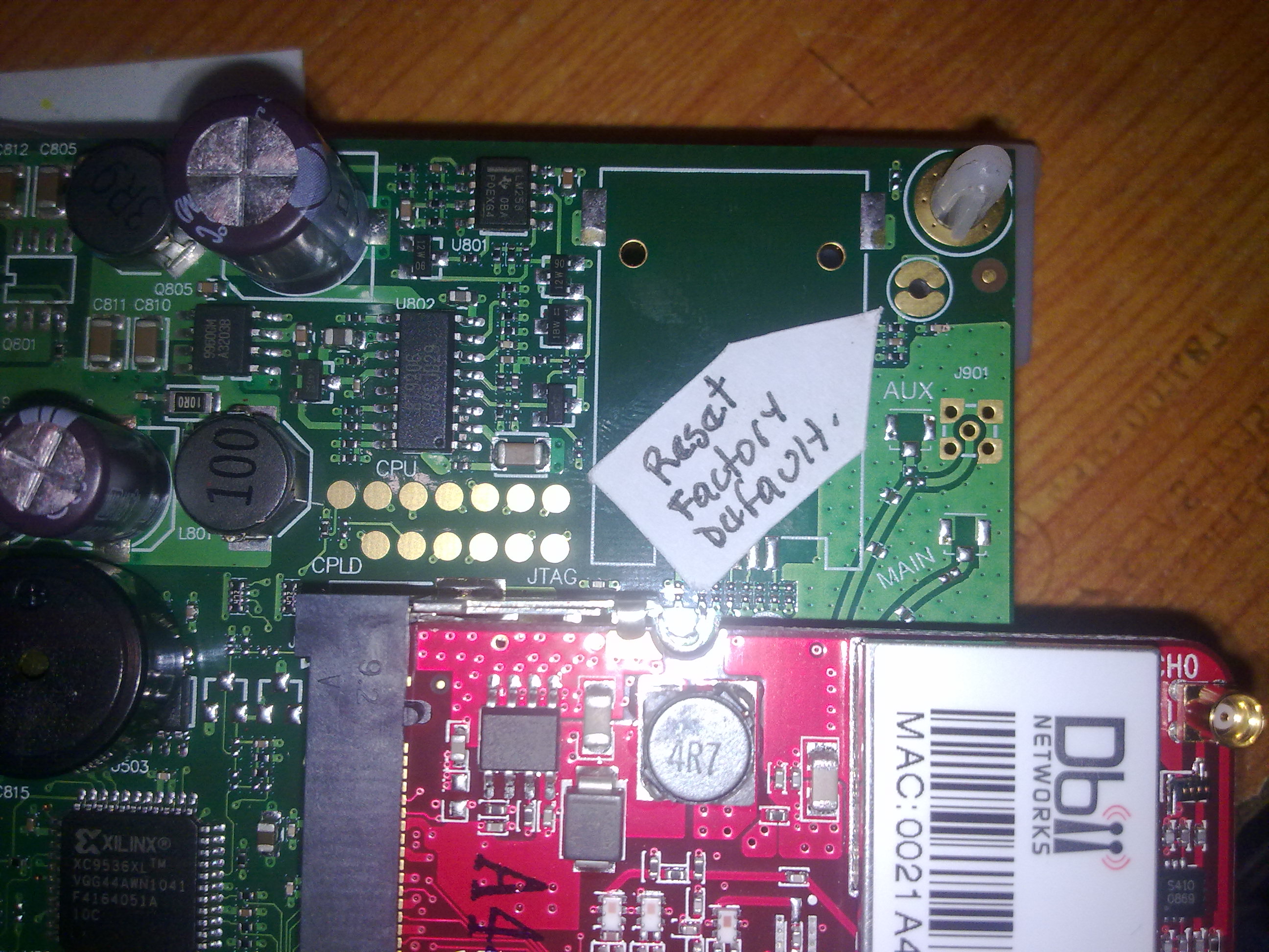

can do a factory reset, connecting the contacts of this point in the picture below. I have already had these problems with these cards and the version 5.5 to 5.7. greetings.
i chaque that all…Eth.1 is Enable and there is no problem in cable(i changed it) and also factory reset too… but problme is not
solved…
ethernet is burned, you must change the ethernet chip.
