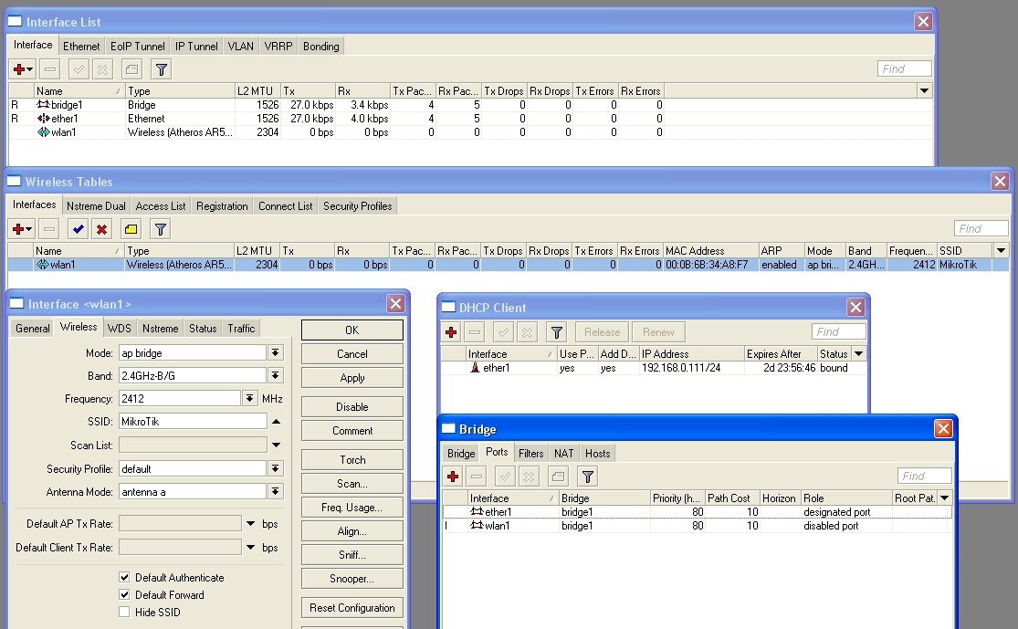

Do you have the ethernet and wireless added to the bridge?
Does the RB450 have dhcp configured?
I asume that the 450 is already setup with a dhcp server, so that clients connection receive an IP.
then just setup the 411 like this.
Setup a dchp client for ether1
setup wlan1 as ap-bridge
create a brigde and under ports add ether1 and wlan1
that’s all
rgs Pilgrim
