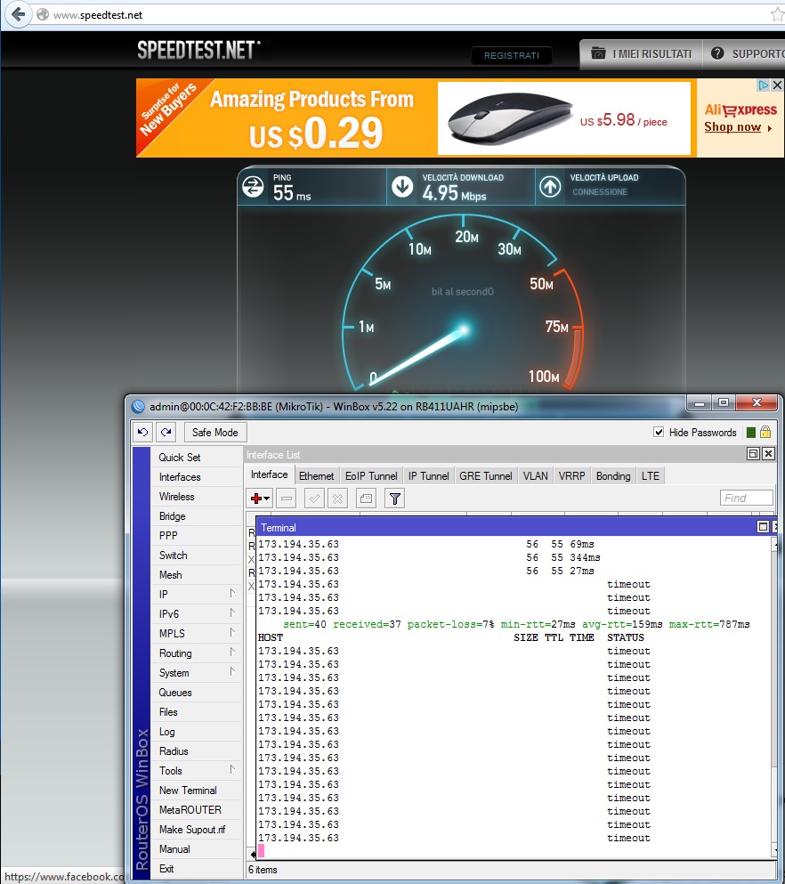

now the test is 411uahr+sierra mc8801: when i make a speed test during the upload the the mc8801 stop working and have to poweroff the board.

are you sure that this is not a complaint to be filed to your 3G provider?
3G modem is recognized, and has connected. Now everything is done in the modem. RouterOS doesn’t affect the speed and latency. Call your phone company
