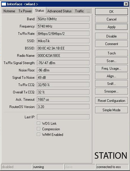

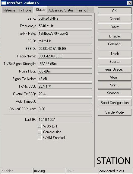

I attached a screenshot of my status window. The TX side is going bananas… between -70 and -35 and constantly fluctuating. The RX side stays consistent between -47 and -52.
CCQ is always low. Once, when throttling all the way down to 6mbps-only with Nstreme and max power I got 98%/60% CCQ. I cannot reproduce this though.
I cannot get the radios to see each other on 5GHZ-5MHZ or 5GHZ settings. Only 5GHZ-Turbo & 5GHZ-10MHZ will they see each other.
Freqency scan on the AP side has basically -109 or better noise readings. Frequency scan on the Station side has -96 to -99 readings. The AP side is in the middle of a city (130ft high) and the Station side is in an extremely rural area (400ft high) with basically no one living around it and no local WISPs in the area. I found it odd that I got better noise readings in the city than in the country.

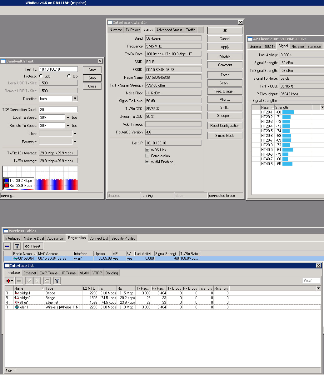

I am now using two RB411AH w/ matching SR71-15 on this link. Link is not perfect and signal strength bounces around. Not sure if it’s an issue with the cards or what. But if I cap each side at 30M in bandwidth test then it stays solid. If I go higher the cards start out good and then bomb down to a bad CCQ and lower rates.
Almost forgot, passing 30M/30M I get 3ms to 8ms ping times consistently. No traffic I get 1 to 2ms consistently. Very impressive, Mtik!

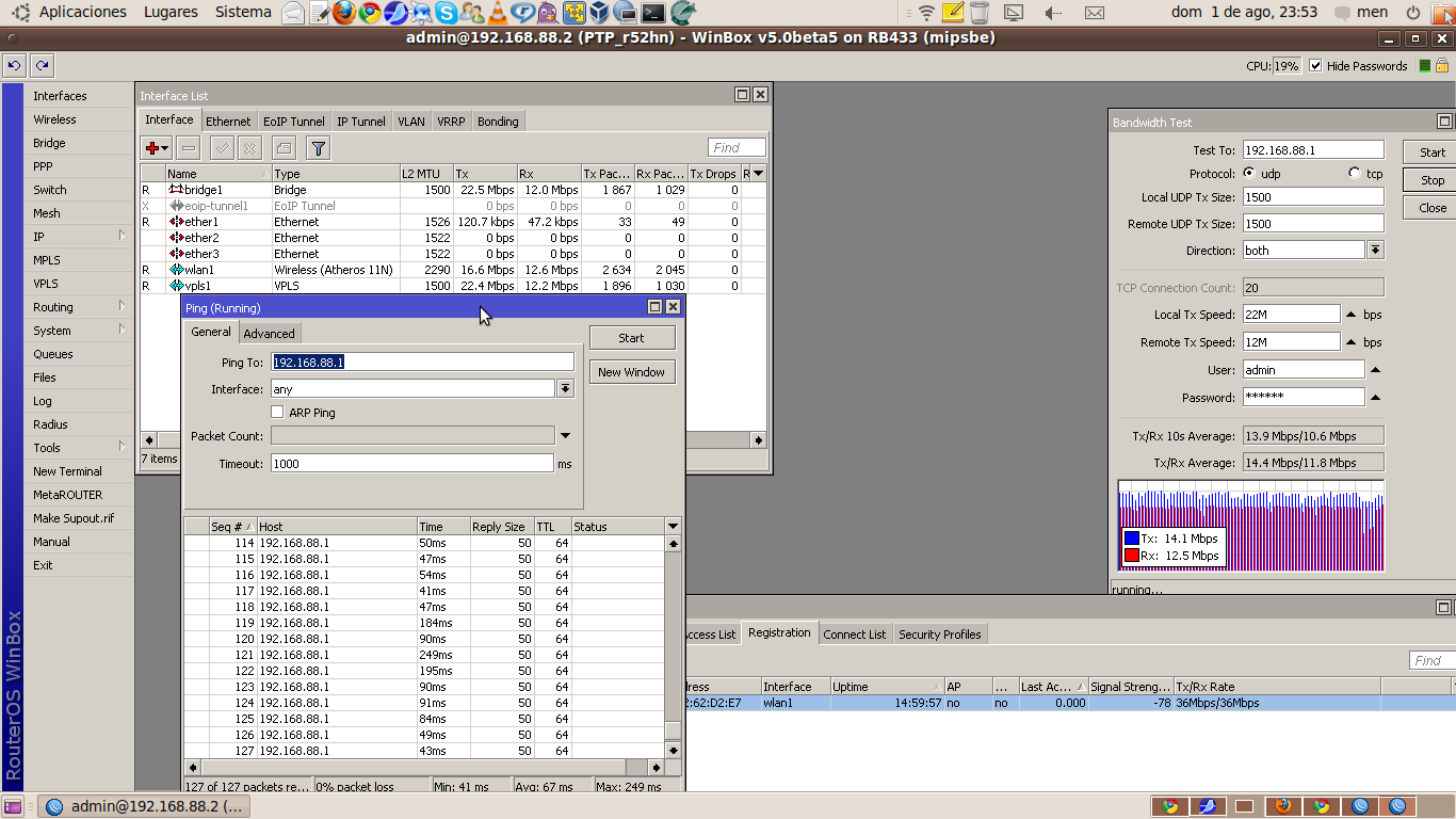

Hi, this is a capture of my configuration, is a 44km PTP with rb433 r52hn antenna Kozumi (28db V / H).
disabled csma
protocol= nv2
tdma period size = 10 (is 10 because 2 was unstable and 7 smaller bandwidth)
Extension Channel = HT BELOW CONTROL
distance = 44
adpative noise inmunity = ap&client
I can not get a link like yours!
