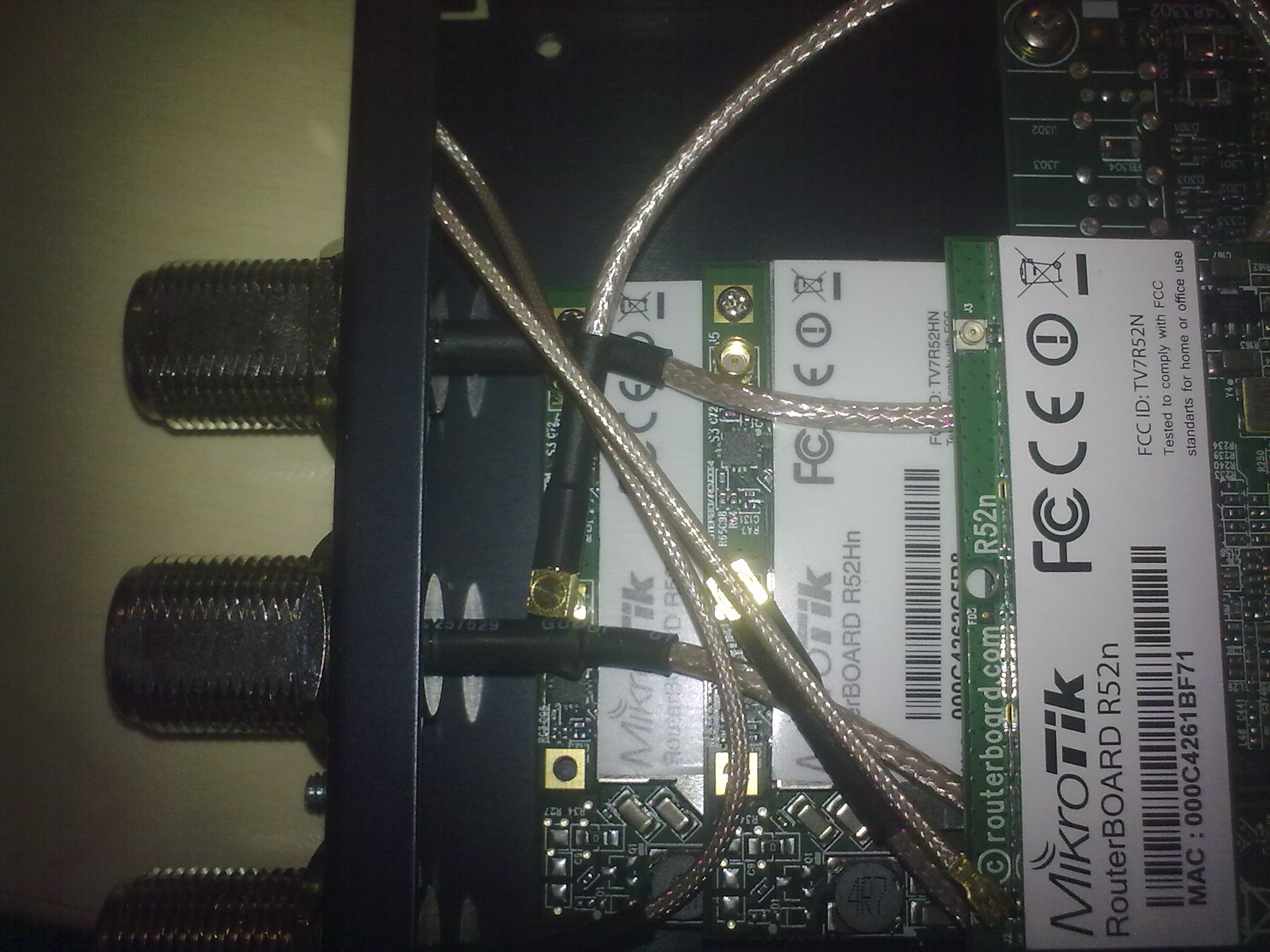

does anybody know whether is a new 433 case or not? (or planed?) The actual problem based on the new radio cards (e.g. R52Hn) they have an MMCX connector and if you try to use 3 cards inside of one case you will get a nasty surprise. There is not enough space, you can’t use 3 cards. Absurd, you buy an RB for 3 radio cards, buy also the case for the RB and the radio-cards itself but you can’t use this configuration.

we use the RB433 for installation inside of a camouflage housing what allows the usage of indoor cases/equipment (but not without case). Its not possible to use bigger cases because there is not enough space. By using the “old” R52H with uFL pigtail we have no problems - why mikrotik change the pigtails? Better performance (lower losses)?

sure, but in our last installation 50 x 433RB with 3radio cards each, we have nearly at all radio card the problem what the pigtail (MMCX) bail-out from the connector so that we have to fix the pigtail at the connector by superglue.

Yes, they do - the cable by himself is really stiffy - an if you 3 cards connected you get also a problem with space near the N-Connector
→ look at the following pic
rg,
maxeschm
i find this arrangement cumbersome . n the ufl is OUT… not MMCX
