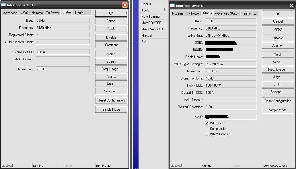

Hi all,
I’m having an interesting problem that I don’t understand.
The setup: 433AH + XR5 + 3ft. dish on each side. PTP nstreme.
Distance ~ 5 miles
Everything looks great - signal, s/n, CCQ.
The problem is with bandwidth. The tests i do with two routers (493AH & x86 1Ghz) attached to the radios.
TX: udp or tcp ~ 24 Mbps (CPU limited, i believe (433AH running @ 100%))
RX: udp ~ 44 Mbps - TCP ~ 8 Mbps!!!
I don’t understand why this happens. MTU on all interfaces (routers & radios) are at 1500. Should i try 1480 on wireless interfaces? Could that be it?
I have NO errors on any interface either. NO ques either. Conntrack is off on both radios.
Thanks for your help.

If your CCQ stays at 100%/100% on both sides while you are doing your TCP tests then we can safely rule out a link issue.
I would then look at perhaps doing a bandwidth test using devices other than the units themselves.
Also, post more about your config and settings.

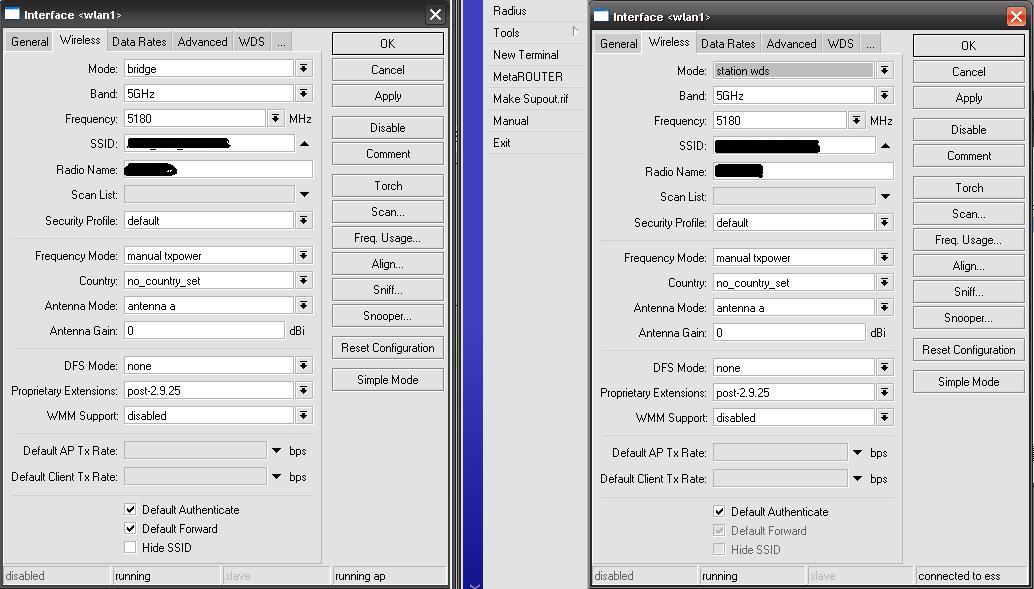

I will put command and screenshots (further down).

The speeds I reported are from devices other than the radios.

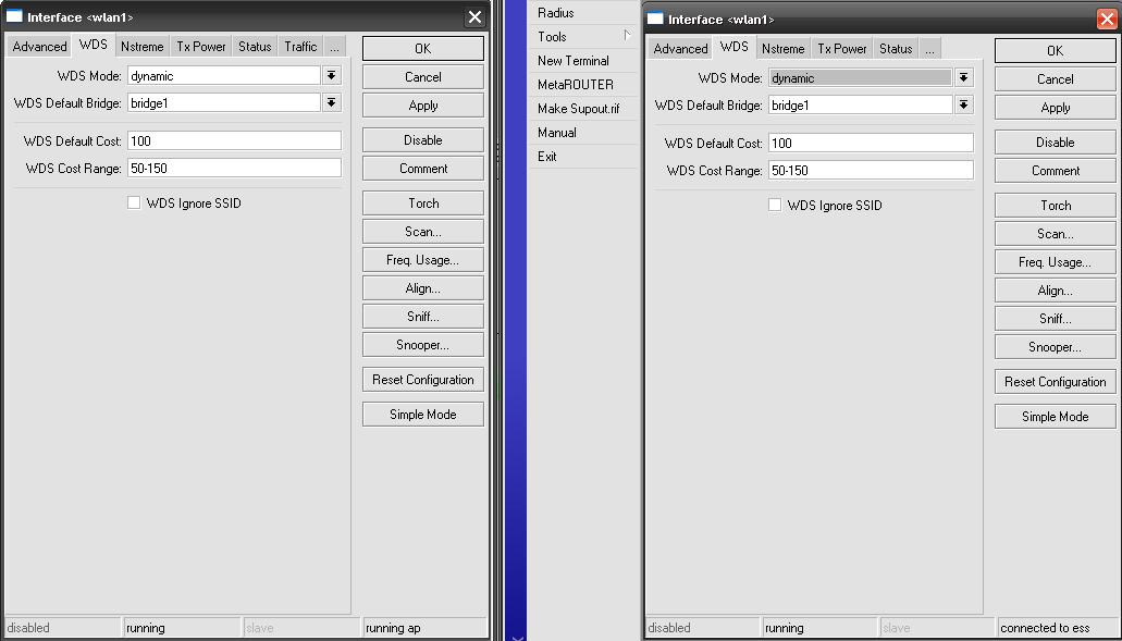

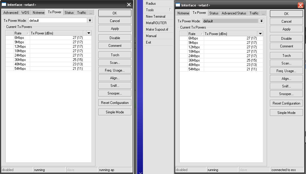

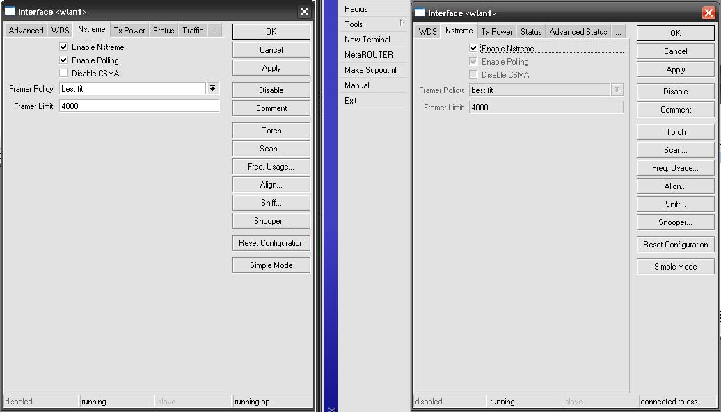

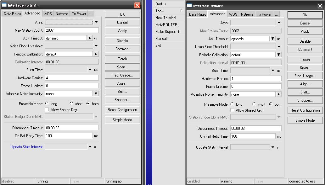

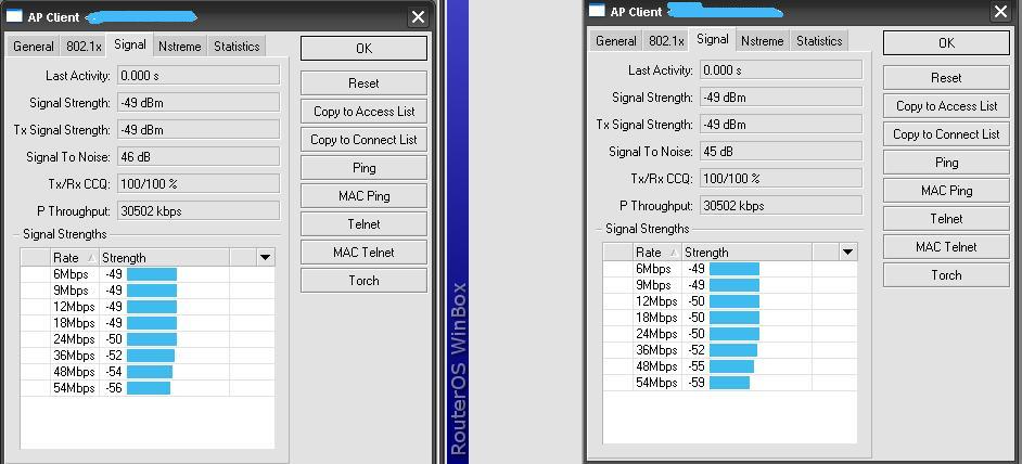

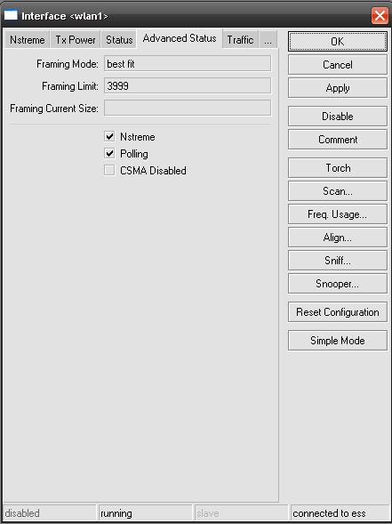

Here are the screenshots.
Some more.
This is off of “station WDS” radio.

decrease tx-power on both sides, to obtain -60 / -64dbm.
regards
I had the boards in the office and put the pigtails close to each other (the signals being the same ~ -45-50, with ~ 50db S/N) and ran bandwidth tests and the results for the TCP RX were ~ 35 Mbps.
I will try setting the signals lower to see if RX TCP transfers improve. I will post results later in the day.
Thanks.
Signals adjusted to -60 to -65, signal to noise now went to about 30db, BUT no change in bandwidth. It’s still maxing at 8 Mbps.
