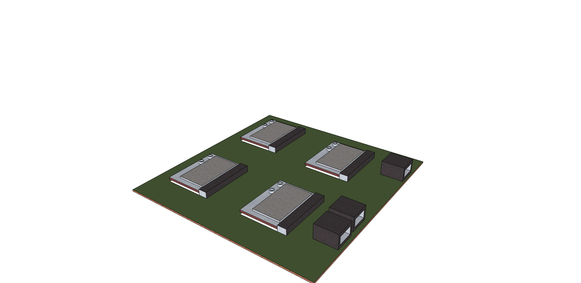

Well, the problem is the routerboard itself. Those three minipci slots are way to close to each other, it’s a design flaw - nothing more.
You just can’t stack wlan cards one after another with 2-3mm gap - this is just against common sense.
Every routerboard model since RB532 with multiple minipci slots has the same problem.
RB600/800 has a little better solution but it still could be much better.
Because of that, I often see dangerously high signal level between wlan cards on the same routerboard (something like -15 to -20dBm) - all you can
do is to lower output power off all cards to somehow manage interference and it is just plain stupid and pointless - it’s much better not to have this problem in the first place.
Mikrotik guys, sorry but that’s the way it is.
So, what is the solution? Simply make bigger distance between minipci slots. Obviously, it’s not practical to stack them vertically so disperse them on the both side of the routerboard if needed.
You should really consult an experienced RF engineer about this issue.
(FYI - I’m managing a few thousands of rb’s with 2-3 wlan cards (on average) on them so I know what I’m talking about).
Maybe something like this :
Cheers :slight_smile:
