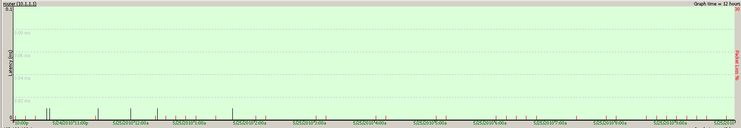

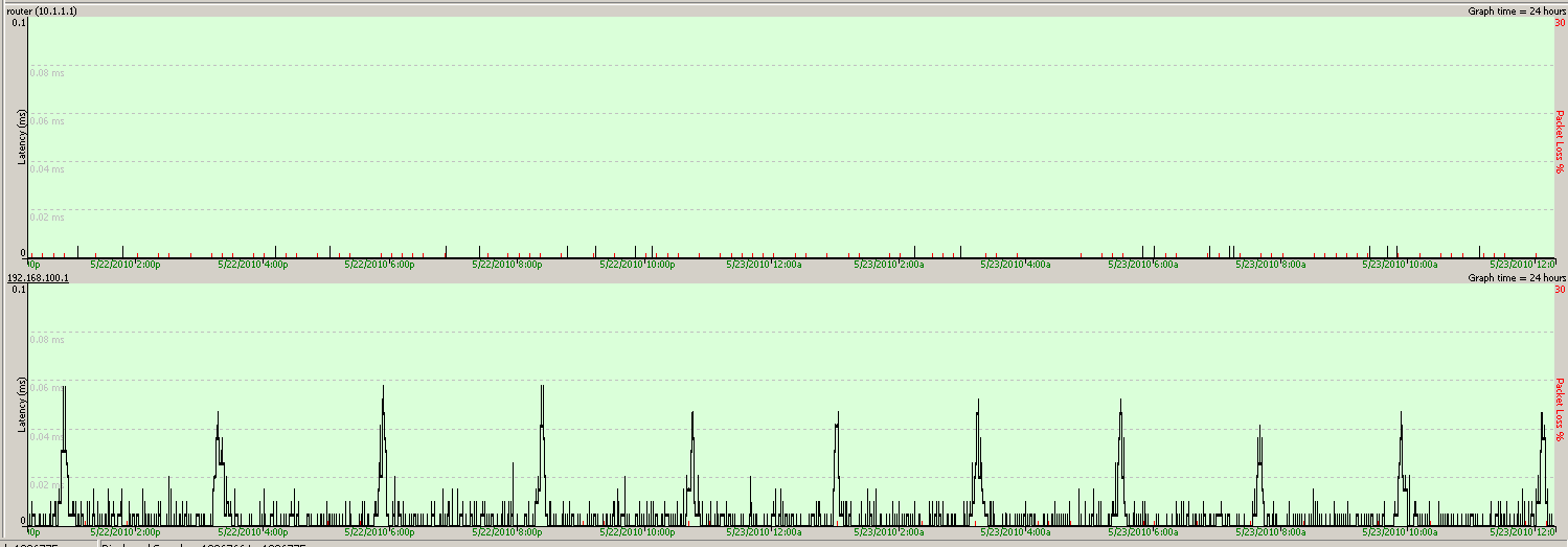

A sample 24 hr plot. Note the scale. Top of the scale is 0.1ms.. I am using multiping to ping the LAN side of the router and ping the cable modem thru the router.
I am pinging at .1 Sec intervals, 10 times a second. This provides a high resolution plot.
The load on the CPU of the router can be sensed by how quickly the ping is returned it turns out.
Top chart is the 450G
Bottom chart the cable modem thru the router
Typical 24hr period. The cisco cable modem does some weird stuff.. The 450G is perfect… Over days.

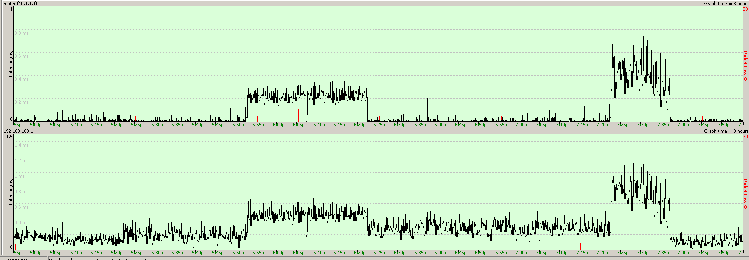

Once I started the Metarouter these plots changed and got quite noisy. I presume a higher CPU load to run the Metarouter. But odd patterns emerged. Fairly long periods of what might be higher CPU usage.. The loads on all the routers had not changed at all. This was not seen in 5 days of plotting…
Note this is a 3hr chart and the scale is larger..
This is most likely meaningless.. But interesting :slight_smile:

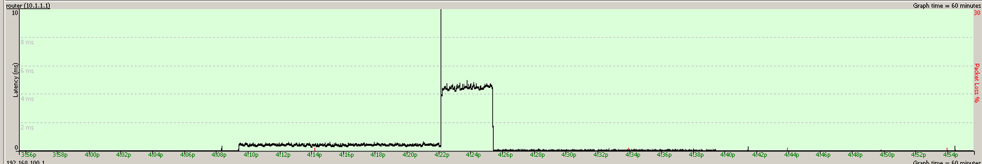

So a baseline… This is the router with the MetaRouter set to disabled.. Note the scale. Full scale is 0.1ms. This is a 24 hour chart recorded with 100 ping per second resolution. Im pinging the LAN side of the router. I have Multiping options @ .1ms ping interval, 0 interval between pings, 28 byte packet size..
Then I turned on the meta router.. My CPU usage increased, Winbox siad about 2%-7%. In fact its amazingly visible.. Note the scale is 10 times higher now at 1ms. So this is at least 10 times noisier.. The red spots are 100% packet loss, this is the “hang”.. During 24hrs it got hung up twice. But different intervals, no log entries, not triggered by any action I can see. They are also not a set distance apart in time. The hangs were 2min 49 seconds and 9 min and 50 seconds.
The more interesting parts are the raised ping times that last for 10-30 minutes.. Must be higher CPU usage ? There is no additional data traffic during these intervals. In fact really heavy data flow does not seem to effect these results. High data flow does not lead to much increase in ping times at all.
Later I turned off the meatrouter and everything returned to normal..
So what does this tell us… Most likely nothing !.. Might just be normal…

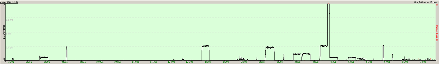

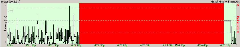

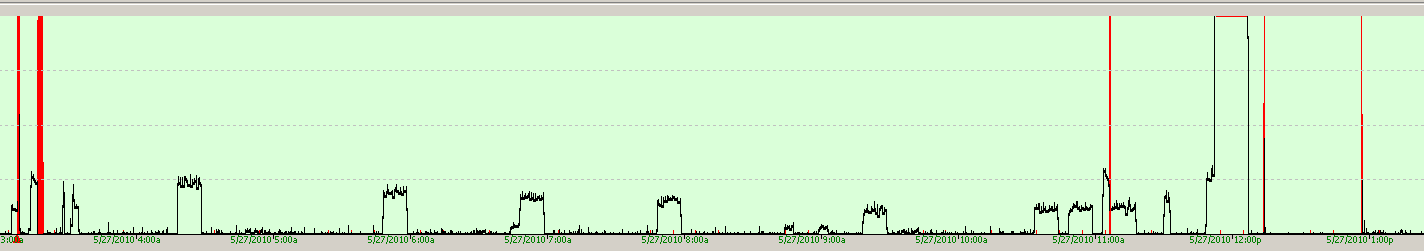

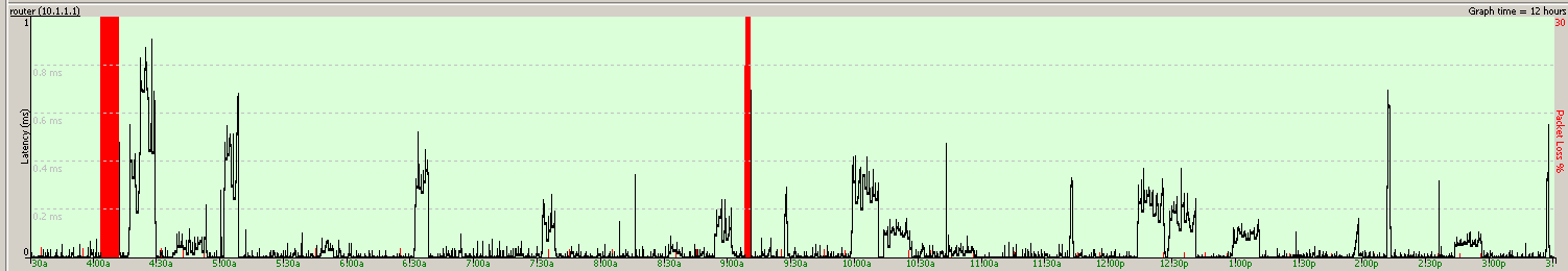

This was before my cap mod.. This shows red packet loss when the router hung up. It also shows to ever present increases in ping times sustained for 10-30+ minutes..

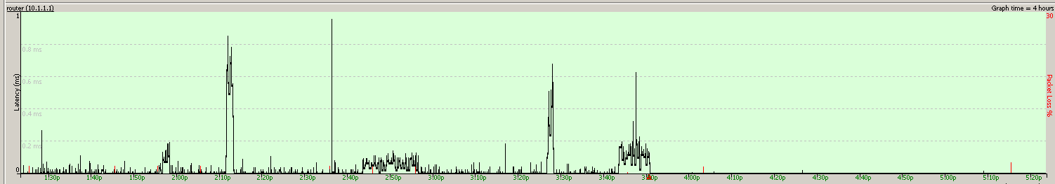

I then did the cap mod.. Strangely the plot is cleaner.. But the import thing is no red blotches..
There is however a weird increase in ping times that went off chart..
Zooming in on this section of chart..

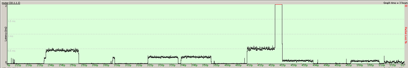

Zooming in more on just the 4 minute high spike and changing the vertical scale so I can see the whole spike, I notice a much shorter spike that is WAY off the scale.. And this spike preceeds a much higher then normal ping time..
Looking even closer

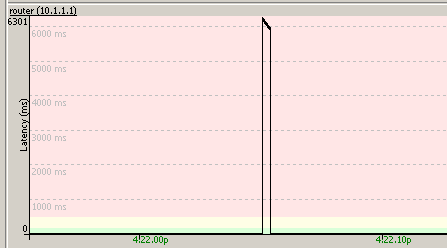

Zooming in more on just that spike and allowing a MUCH higher vertical scale..
This yielded a HUGE ping spike which was around 6000ms or 6 seconds.. This lasts for around one second and I have about 80 pings for that second.
THIS spike is unlike anything I have seen during my testing so far.. This was some REALLY HIGH CPU usage.. However it did NOT cause the MAIN router to hang up this time.. Maybe that cap allowed the CPU to keep running through this obvious spike in usage and CPU current draw..
The Metarouter however DID hang up. It locked up at exactly the moment of this spike…

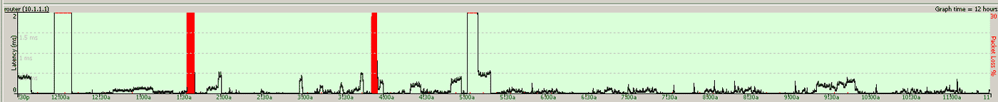

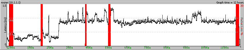

I spoke too soon… I think I am mistaken…
Man this problem is annoying…
From the last 12 hours.. Clearly the problem is still there, just like it was before… I think…
So I am afraid Network Pro you will need to take back your Karma vote ! hehehehe

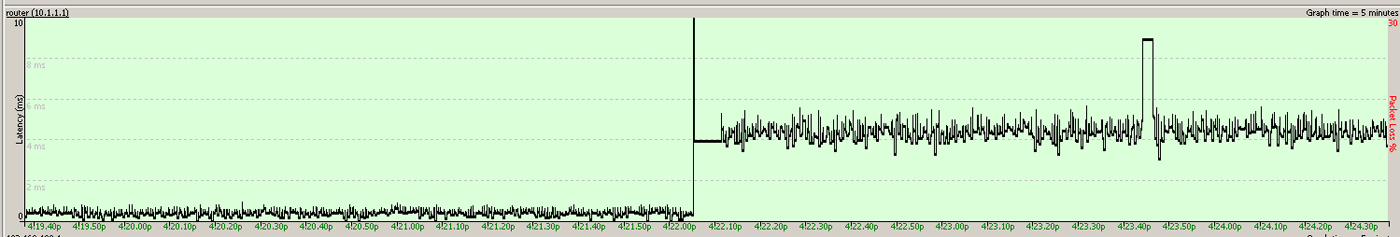

Hmmmmmmmmmm…
This is from pinging the main router on the LAN side…
And this is from pinging the MetaROUTER from the Meta Router LAN side. Notice how pings went up and stayed up. Notice right at the end when I rebooted the router and pings came back to normal.. And note how some hangs on the main router did not result in lost packets, just really long ping times..
