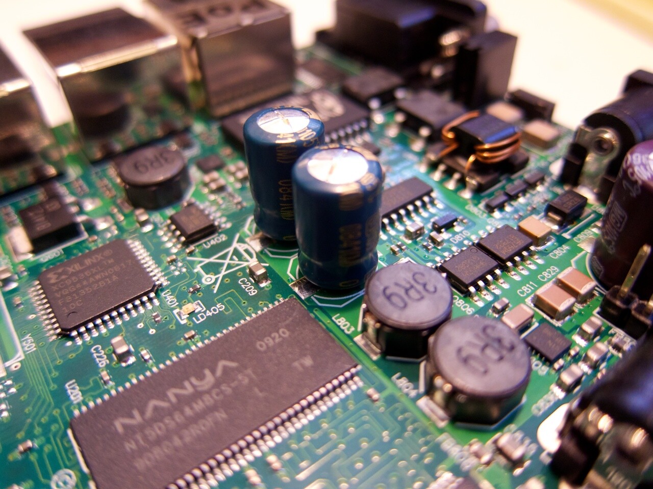

Hi there,
My 450G died on me this weekend. I’ve had it running for some two years or so with no problems whatsoever. I have the feeling it is a serious hardware problem as it won’t beep when I apply the power. Also a reset (holding reset and plugin in power) won’t make any difference. Serial cable don’t report any chars when booting and the link leds on the interfaces stay off.
Is there a check I can perform to make sure it’s really dead as in dead? A visual inspection of the PCB doesn’t reveal anything. I also don’t smell anything burning when doing a ‘nose check’ over the PCB. I just read something about faulty capacitors. Is this a common cause?

Are the electrolytic capacitors bulging on the tops or are they still flat as they should be?
If bulging, they need to be replaced.
Tom
They are indeed bulging and not perfectly flat. I think I’ll visit the local radio shack and give it a go. Will report back when I’ve replaced them.
Thanks Tom
A photo says so much more.
Just paid a visit to the local radio shack and he was positive those electrolytics where bulging. Spent €1.20 for two new ones. Cannot get 560uF but the consensus is that 470uF will suffice just as well. Any thoughts on that?

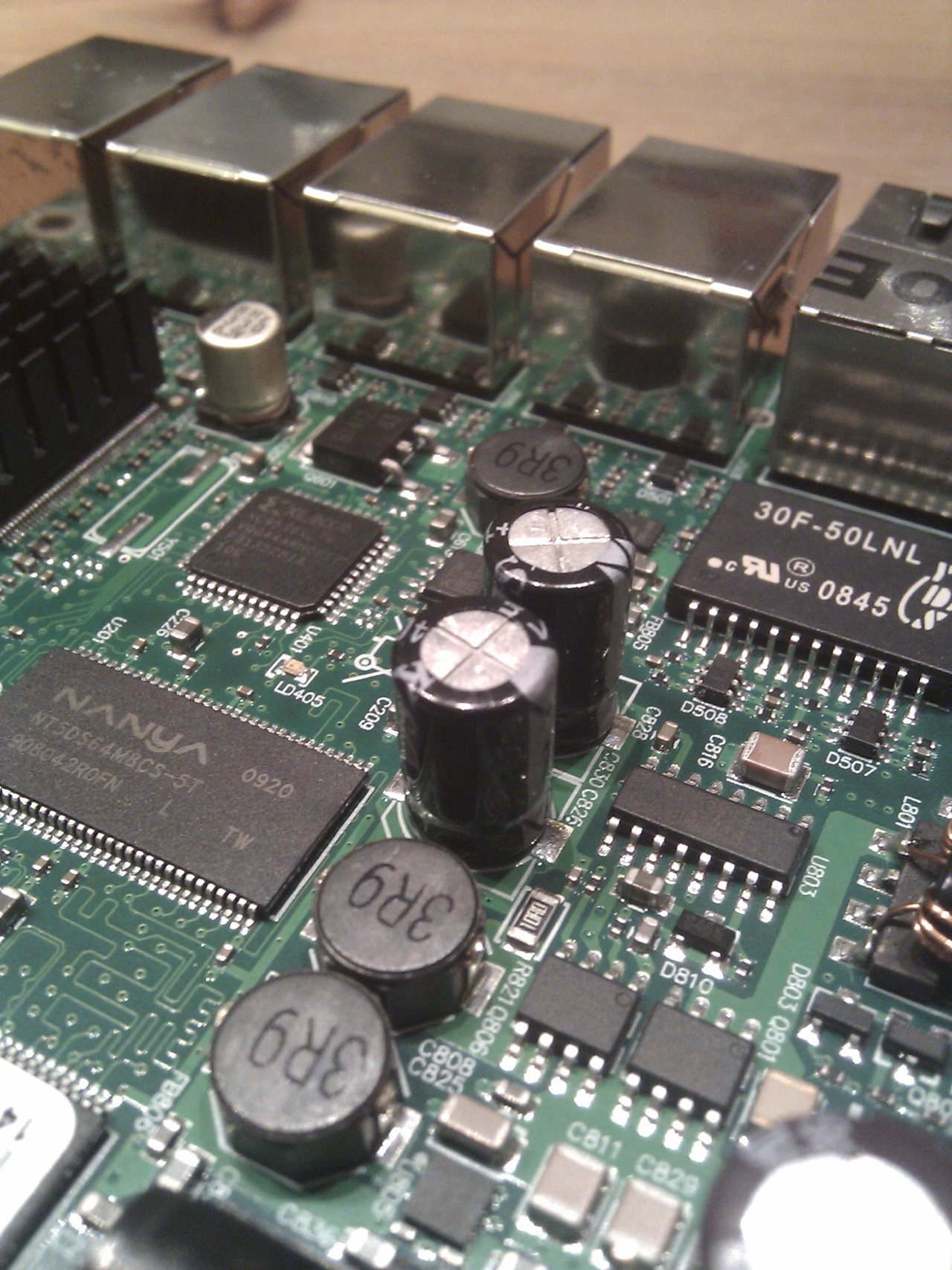

We have been changing capacitors on our failed RB450s for years, usually to 1000uF ones. The units work perfectly after the operation. Search on the forum, and you can find several topics about this.
Replaced the old capacitors with new 470uFs and it spun into life. Sweet! The Routerboards are an amazing piece of hardware and I would buy one again in a heartbeat if this one fails beyond repair in a near future. Too bad there are series out there that are plagued with the faulty capacitors, but that’s some upstream component problem a lot of hardware builders are troubled with.

The cause is not Vin or temperature. Those 2 caps are for voltage smoothing on PWM converter. Since the routerboard draws lots of current, we need low-esr caps here. Sanyo OS-CON, NCC polymer or any type of low-esr is preferred here. Regular caps from RadioShack may not last. When I received the RB450G, I replaced them with 2 620uf/6.3V OS-CONs already.
just a note - this can happen only on older RB450Gs, we have switched to a different supplier in the new revisions and this problem doesn’t occur anymore.
