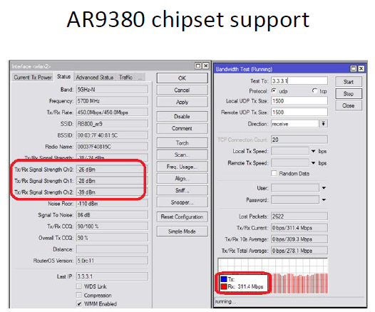

I saw there is the wireless connection can go up to the 450M/450M on with the AR9380 wireless card.
this information is from the China 2011 MUM presentation slide.
just want to know, it’s this possible and what’s the actual throughput we can have it?
thanks
you are already looking at the picture, so it can be done and you can see the speed. :laughing:
angboontiong why are you asking, if you already know the answer :smiley: it’s in the screenshot!!
