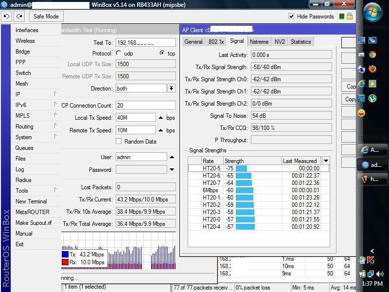

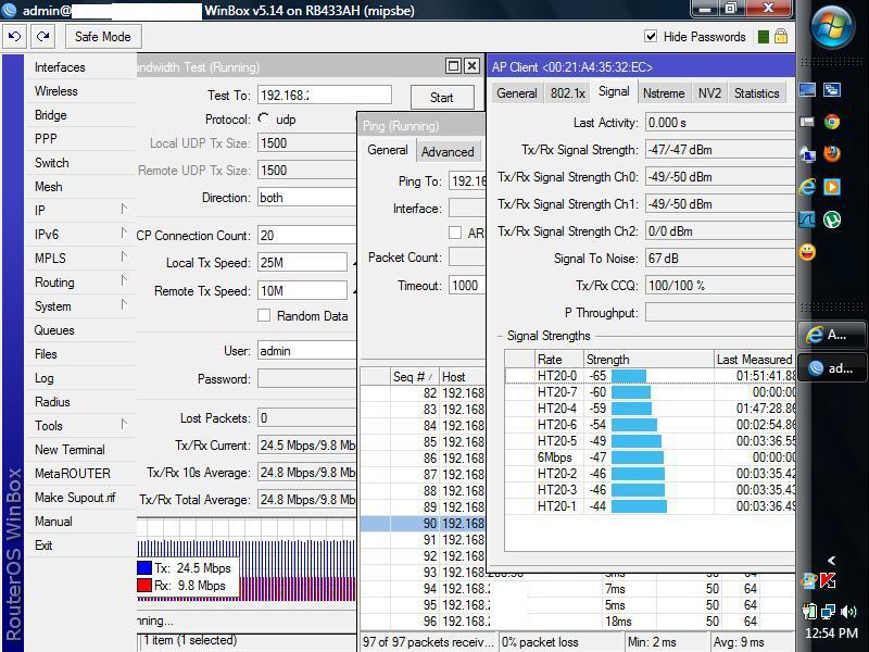

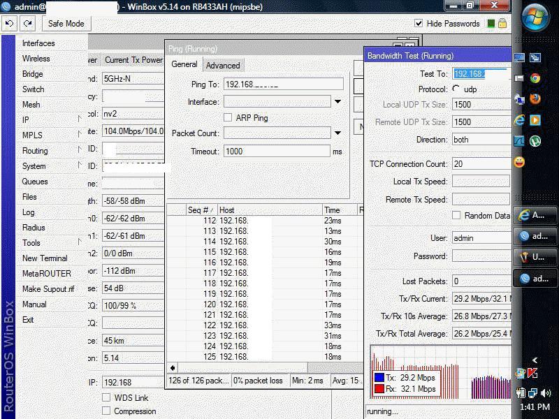

We have installed 46 km P2P wireless link. 80 % of the link goes above the red sea (Saudi Arabia). With different modulation(HT MCS) we got below link result.

I have installed below hardware.
34dBi UBNT dish, RB433AH and Alfa cable.
Nv2 over 20Mhz.
Sometimes during the day signal fluctuate from 44 to 60, this is because the link travels over the sea.
I changed Nv2 to Nstream. Result is very poor. Normal ping is 1ms.
but when i try to put 5Mb of load CCQ start jumping from 90 range to 25-35. and some times it disconnect.
What i have noticed is that from AP side RX CCQ is very stable. It remains 100% but tx CCQ drops to 20 and than it disconnect.

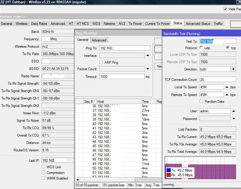

After upgrading 5.15. CCQ is very stable. On 40Mhz i got 90Mbps total link capacity.
Tomorrow I will post my picture
I have got 40Mb 40Mb too but SNR is 51 vs your which is 99%
I need to little play with MCS for sure.

have you manually inserted the distance to 44kms?
Manually i put 46km (Google Earth measurement) but it comes 44km.
