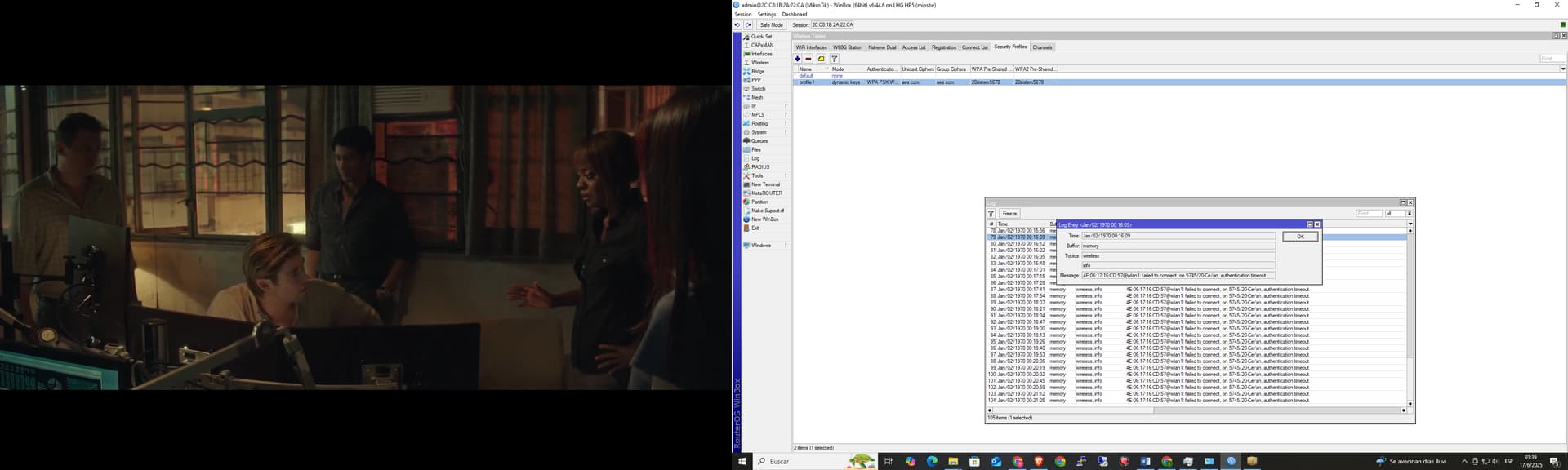

4E:06:17:16:CD:57@wlan1: failed to connect, on 5745/20-Ce/an, authentication timeout
Hello community, I’m having problems with a couple of HP LHG5. They won’t connect to the access point. The error I’m getting is as if I entered the wrong password. I’ve tried with other HP LHG5s and I haven’t had any problems. Has the same thing happened to anyone else?

What RouterOS and firmware version are the devices involved running?
Hi Erlin… I’m aware that I published the passwords… don’t worry, it’s a laboratory… I’ve already tried different versions in 6x and 7x.
