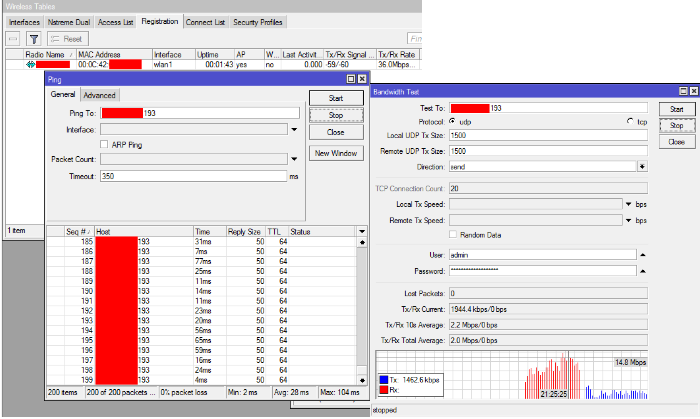

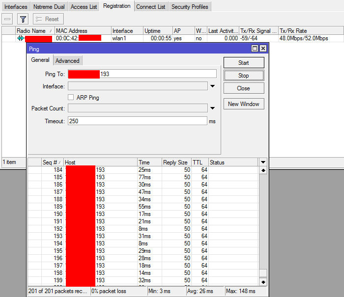

I’ve a RB433GL with two radio with 37 clients connected.
I try to upgrade the AP to 5.21 and test one client (with good signal)
Before client had a Groove with version 5.8 and firmware 2.34
After the upgrade had routeros versione 5.21 and firmware 3.0
The are an increment of the Rx signal of about 4dB but result was not so good
I attach the screenshot
BEFORE
AFTER
Why latency is also unstable and high?
