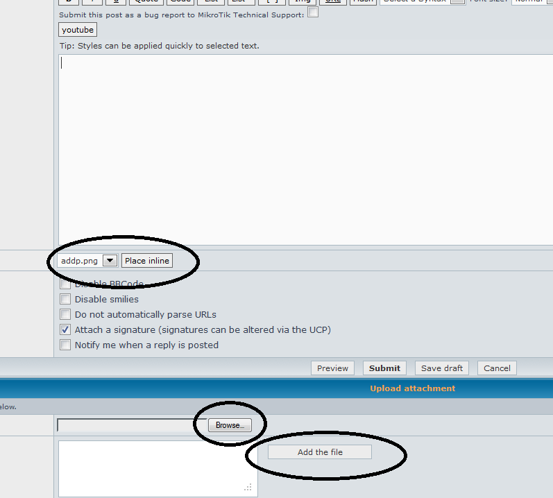

How can i insert here picture?Sorry for my bad english
First Browse your file than add the file
and at the end place inline
The place inline is does not appear for me
First browse and add the file
Than it will appear

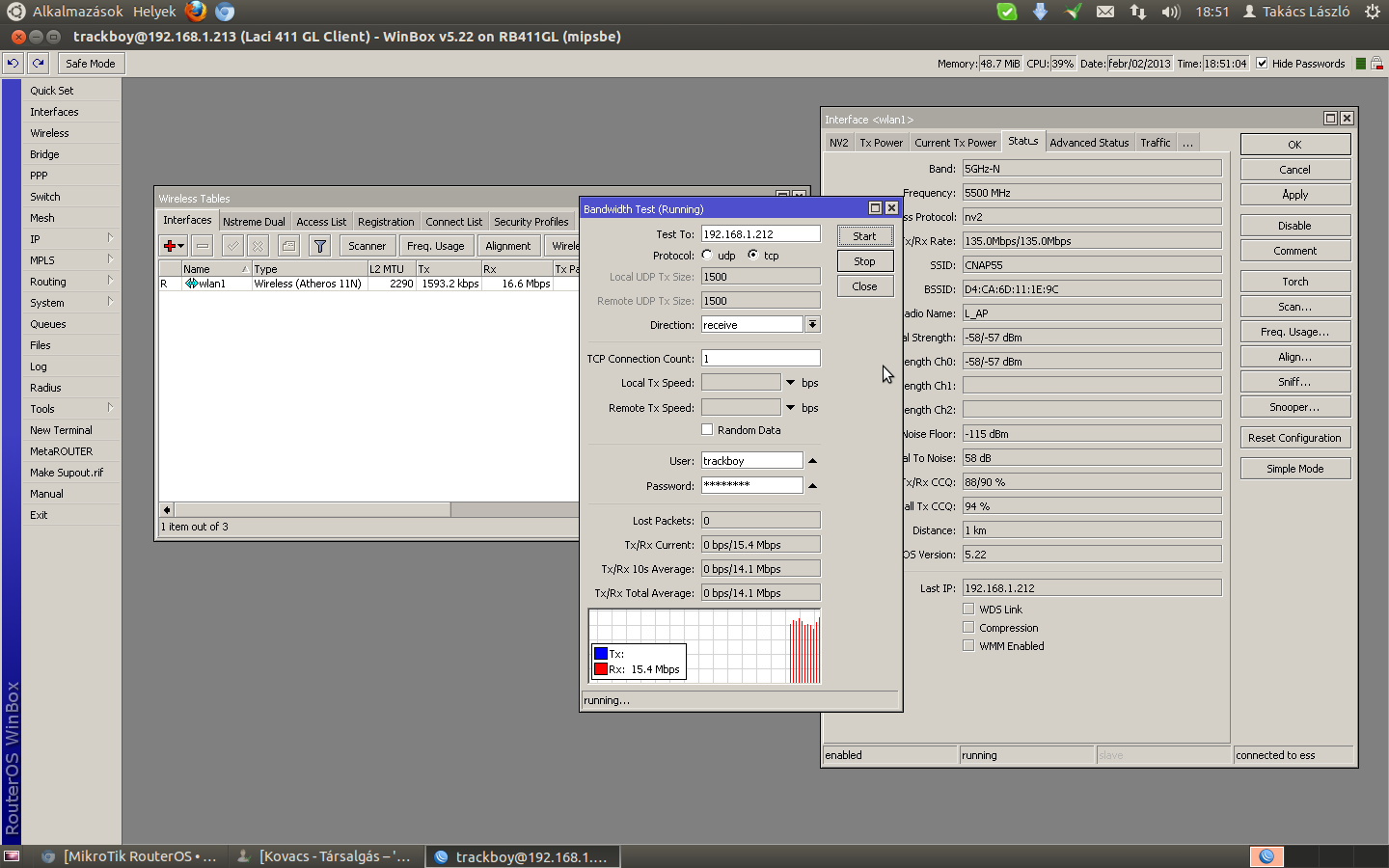

Ok,here is the picture,the result is same with 20 TCP count too
finally Trackboy picture :slight_smile:

Why tcp count 1? Set it to 20 as it is default.

Ok,i will test nstreme with UDP,with 20 TCP count the speedtest result is same
