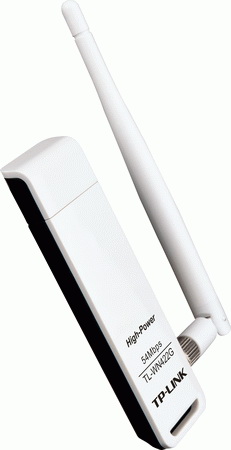

then tell me what is my solution’s buddy i want to provide service in 5 KM roundabout i have 3 secter antenna’s 120 degree 20 dbi 1 watt booster what you suggest me which AP is good for me coz i have more then 400 clients & each client have must 1 mb bandwidth.
I am using in client side wireless usb lan card with 3 to 4 dbi omni antenna with rf cable
