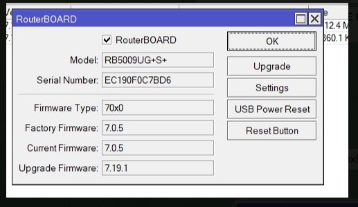

I don’t remeber from which version I came because it’s the first time i seriously configure it, was in a box ready for the new home, but this behaviour was not there the first time I try, maybe 1 year ago.
I remeber that I update from the packages menu of the winbox, like a wizard. picked tha version on the screen
Btw this is the screen I got

Press the “Upgrade” button and afterwards (it will show a text message in red letters saying you can reboot) reboot the device. These steps will upgrade the firmware (and there are a couple of firmware changes between the running and available version).
