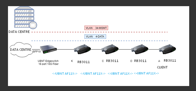

We are trying to delivery a 500M L2 service to a client but are having difficulty in providing 500/500M Duplex. The service is tested according to RFCC2544 where the packet loss requirement is 0.1% (they will accept up to 0.9%).
When the client runs their test they only manage 320/320M with 0.9% loss. We need to get a minimum of 400M/400M, ideally 500/500M
Are there any tips, tricks or things i can change to get more out of my links?
Ive tried everything i can think of
Shifting around frequencies
Playing with power settings a lot until i have found the sweet spots
Enhanced Mimo (didn’t really do anything[Codebox=html5 file=Untitled[/Codebox])
Short CP (Gave a big boost in speed and is currently enabled on all links)
See attached the topology, link count and radio GUIs.
