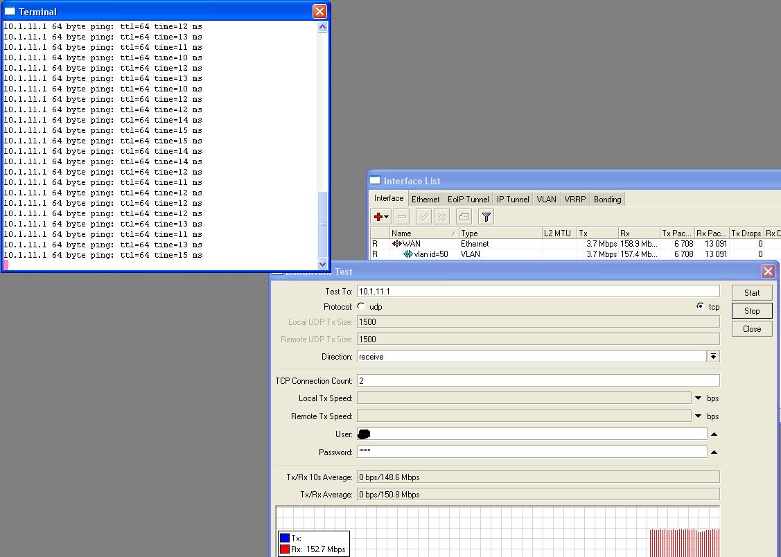

I have 5 PtP links using Mikrotiks I’ve tried dual-chain with. Here’s my experience on all 5. Nstreme does NOT work well with dual-chain. In fact, some of my 150/150Mbps single chain links got WORSE and dropped to 65/65Mbps when I added the other chain. Other links fluctuate wildly from 162/216Mbps, always changing.
Solution? When I run NV2, ALL links stay at a stable 270/270Mbps, CCQ 100% and throughput is best. I would recommend using NV2 for anyone using dual-chain(pol) PtP links.
