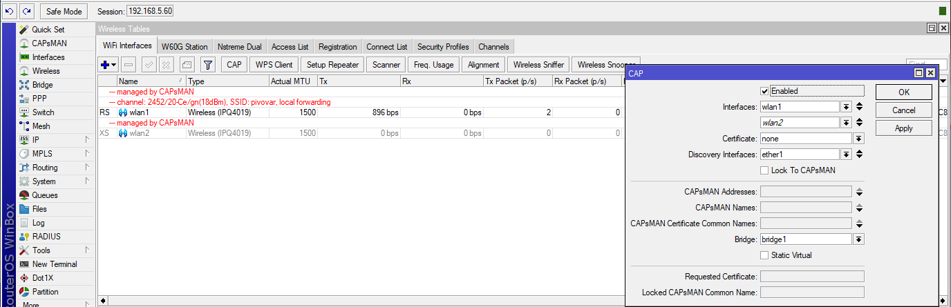

I have several CAP AC in my house that work just fine. Two days ago I purchased another one. I powered it up, made an upgrade to the latest firmware and after a restart, I enabled CAP. It started giving me problems (it simply wouldn’t get IP from the router) so I performed a netinstall to a long term 6.47.10. After that it was running fine after enablig CAP, however 5G radio won’t activate. All other CAP’s have both radios enabled. What could be the problem?
I’m attaching 3 screenshots:
2021-06-09_170536 - CAP that’s giving me problems (I tested also with not specifying the discovery interface, there was no difference.)

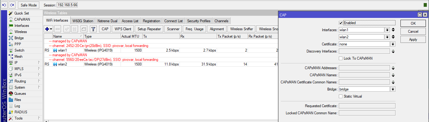

2021-06-09_170606 - An older CAP working just fine

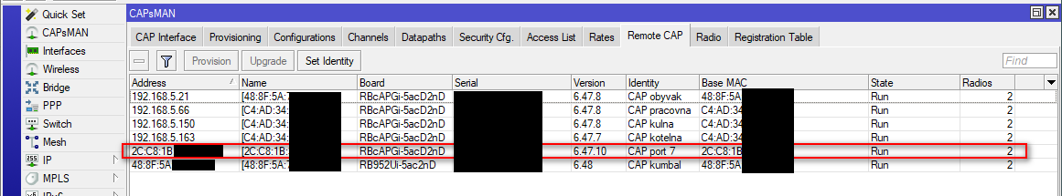

32021-06-09_170627 - Remote CAP list in my router (I’m not sure whether the MAC and Serial numbers should be blacked out but I guess it won’t hurt). I’m not sure why the new CAP and one older switch don’t have an IP listed.
On the CAPsMAN Mikrotik under CAPsMAN > CAP Interface you should see a list of the remote radio interfaces, you can open these and check the Current State entry on the Status tab - it should say running-ap when operating.
Not all of the CAP settings are controlled from CAPsMAN so there may be differences between the two CAP devices, especially if the default configuration was created by different firmware versions.
you have created all provisioning/channel/etc. needed for 5GHz?
