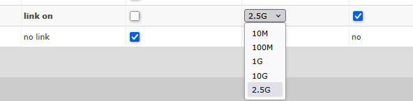

With the availability of Realtek RTL8157 based USB network adapters, which can reach 5 Gbps, the problem now arises that under SwOS 2.17 (CRS309 / CRS317) this speed cannot be selected and auto-negotiation unfortunately does not work either.
I have tested all possible combinations. If both the USB adapter and the switch port are set to 2.5Gbps, the connection is established. With all others, the link does not come up. I tested this with Mikrotik S+Rj10 and Ubiquiti UF-RJ45-10G modules and the Delock USB-C to 5 Gigabit LAN adapter (81570).

2.5 Gbps is working with both modules. But it is not possible to select 5 Gbps on SwOS.
According to the release notes, 2.5 G was added in version 2.16.
