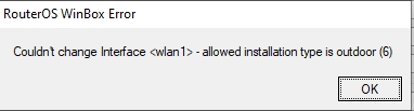

Some MKT devices now (6.44 and up???) only allow “outdoor” as setting , and limit therefore the use to only outdoor frequencies.
E.G. : SXTsq 5 ac, Omnitik 5 ac
Setting “any” or “indoor” is not possible on those devices ( for European countries at least )
So your mileage may vary depending on device and ROS version.
This is not a problem here in this topic, as “outdoor” or “any” must be selected for 5805MHz. Only a general information.
