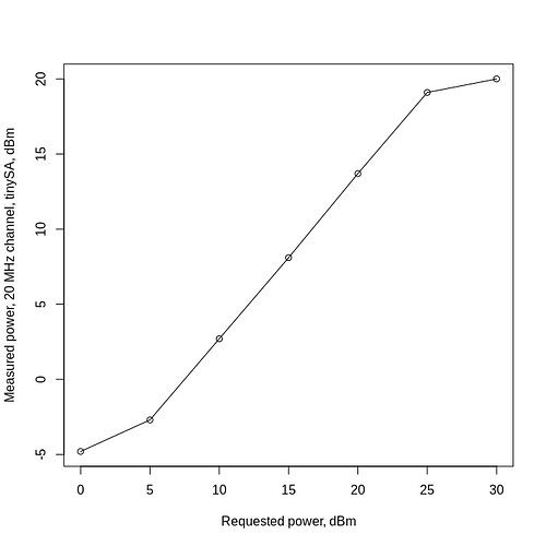

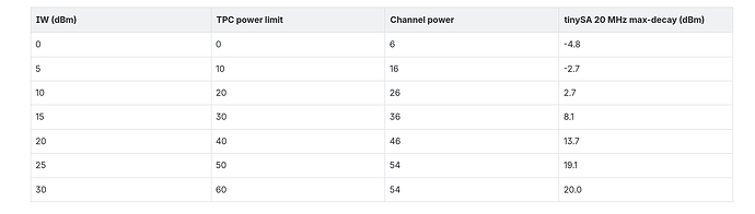

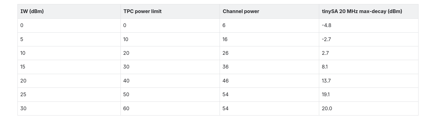

Semi-offtopic question. I’m using a R11-5HacD card in Linux and noticed that either the ath10k firmware is acting weird or there is some issue with the calibration on the card in relation to power. The card is supposed to top off at 27 dBm and indeed it correctly allows setting power up to 54 (internally atheros uses 0.5 dBm increments), but the output power measured by an analyser doesn’t like up with what I set, whereas the driver firmware doesn’t really disagree with what was being set (columns 2 and 3):
There is a huge linear section of that data (before it caps off at 54 as expected) so I assume there is some kind of calibrated gain value error or something that causes the card to pick a wrong setting for the PA:

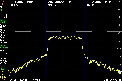

I’ve read that the card’s PA is powered by the 3.3aux pins and some adaptors don’t supply those, but it doesn’t seem to be the case for me because it can reliably output up to 20 dBm no problem:
