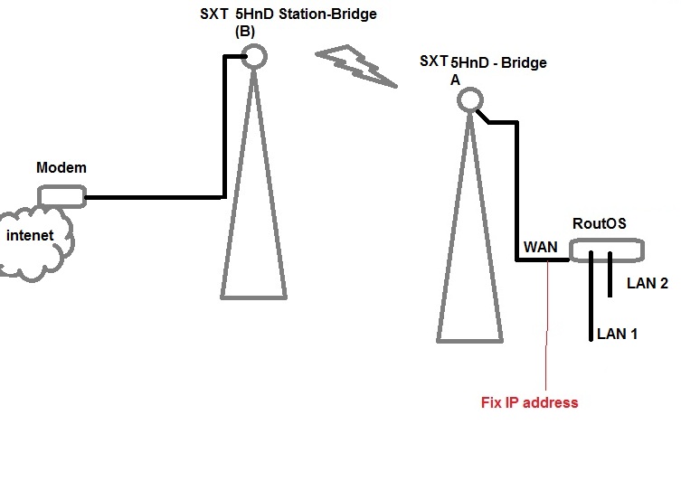

Hello
i have the scenario in the picture (modem → antenna B as station bridge → Antenna A as bridge - RouteOS receive Static IP address from ISP normally with 9 KM max speed i got 3 MB ) configured and working, but always in 3 or 4 days need to reboot one of the antennas to get then connected , and here also i want to know what is the way to configure the antennas to avoid this issue and to get the better bandwidth , and note that when i select all HT AMPDU 1-7 i got signal loss just up to 4 will work .

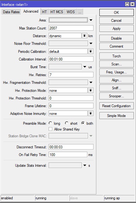

Have you add the distance for ack-timing, see printscreens
Set the wireless settings on advanced then see you more.

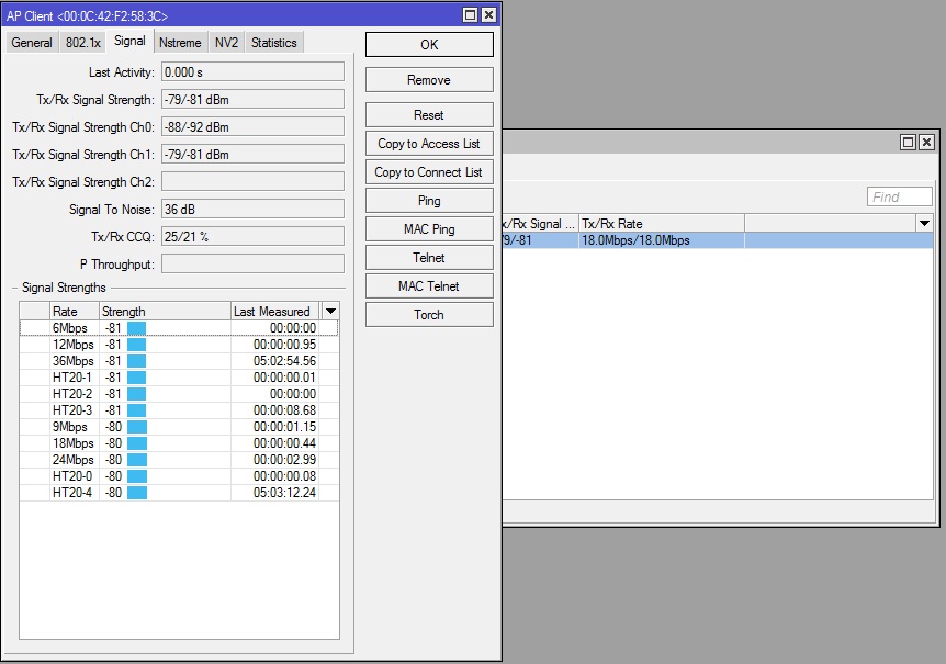

What is the signal strengt

Have you add the distance for ack-timing, see printscreens : Default Value 40 KM
What is the signal streght signal / noice

Ack timeout must an both sites the same setup of cource

The signal is not strong and the tx/rx ccq is very low, with this hardware config can’t you a good result.
